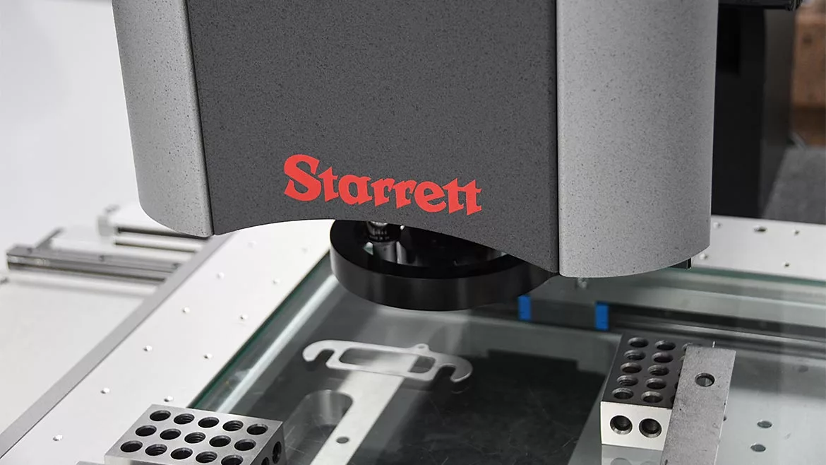

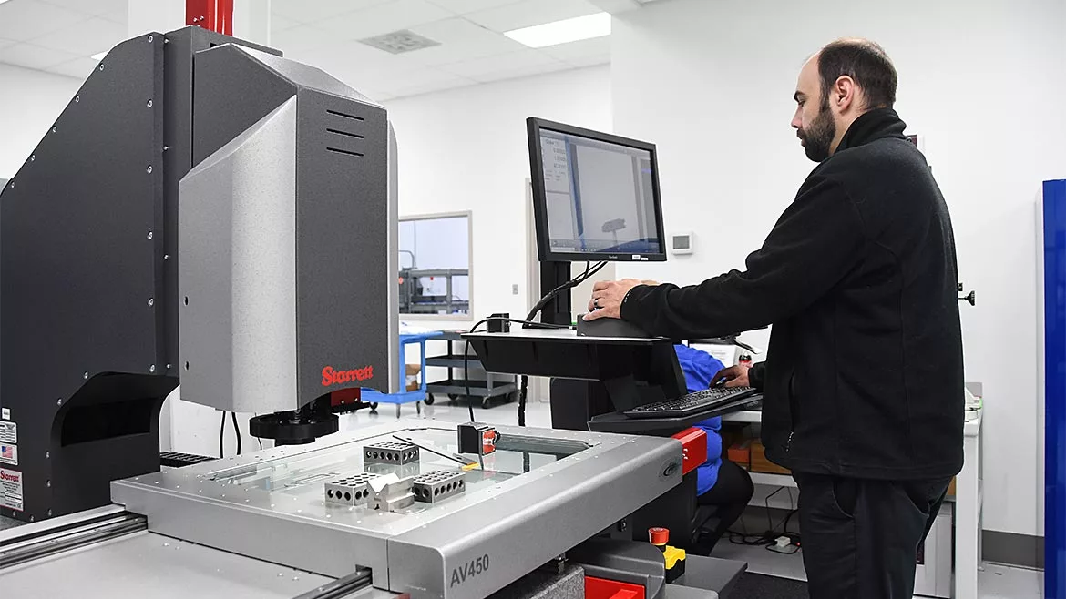

The Starrett AV450 vision system provides RYMS with a versatile, easy-to-use and accurate solution for quickly checking measurements on NASCAR “Next Gen” shims and bushings.

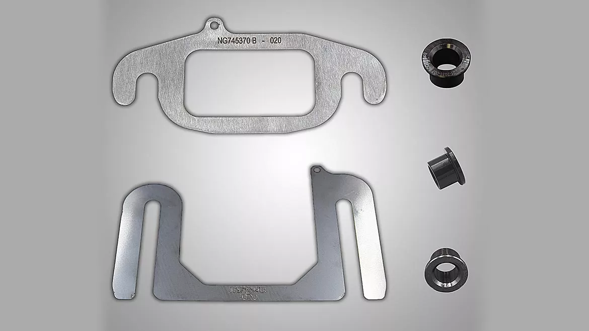

A NASCAR engine typically has 857 components, so some are bound to have geometries that are problematic to measure and inspect. In the case of the NASCAR “Next Gen” car’s bushing, using a touch probe to measure the radii on the undercut presented several challenges which increased inspection time and costs.
Todd English, vice president, strategic partnerships & marketing at RYE, explained, “To get a clear picture of the role of the undercut, it is useful to know that the undercut of the bushing serves two purposes.” First, it allows for minimal chamfer on the hole in the mating part to maximize the bearing area under the bushing flange. Also, the undercut enables a large radius which reduces the stress concentration factor in the bushing.
RYMS Quality Control Manager Ryan Osborne said, “The undercut was almost impossible to check accurately with a touch trigger CMM. The radii size as well as tool offset issues were difficult to see and determine.” English concurred that traditional CMM measurement was not working well, resulting in inconsistent results.
In another racecar part example, measuring a NASCAR “Next Gen” shim to meet specifications presented challenges when probing with a CMM due to the part’s size and flatness. Osborne said, “Similar to sheet metal, it can be tricky to measure edges with touch trigger CMMs. The size and thickness of the shim was difficult to measure with the CMM.” He continued, “We tried to use a micrometer as well, but it would distort the OD.” For both the bushing and shim, RYE needs to meet tolerances of +/- 0.13mm.

RYMS reviewed how the Starrett AV450 vision system could provide the first line of defense for ensuring they were making parts right, the first time. Important criteria for the vision system included accuracy, speed, and the ability to measure challenging geometries. “The Starrett system checked all the boxes and was especially flexible and easy-to-use, so we selected the AV450 and implemented it in our QC lab,” Osborne said.
The 3-axis AV450 vision system offers a cost-effective solution for achieving high throughput inspections, and is ideal for both repetitive, larger part-run applications and routine quality assurance. Featuring a larger X,Y,Z measuring envelope of 18” x 14” x 8” (457 mm x 356 mm x 203 mm), the Starrett AV450 has high-resolution video zoom optics and it can be pre-programmed (CNC) for repetitive part inspection, or driven manually via a trackball for individual measurements. With its highly stable mechanical design, precision linear bearings, and smooth stage motion, maximum performance and throughput is easily attainable. Throughput is further enhanced by MetLogix™ M3 software that controls video edge detection and multiple-channel fiber optic or LED illumination. Computer-controlled Quadrant (LED) ring lighting, sub-stage lighting, and optional through-the-lens lighting meets the most challenging illumination requirements.
Accuracy of the Starrett AV450 Automatic Vision System is 2.5 + 5L/1000 and reading resolution is 4 µin (0.1µm). Magnification on a 24” monitor, 1:1 pixel setting is 31x to 198x 6.5:1 zoom and 26x to 310x with a 12:1 zoom. The system has a 1.3 mega-pixel color digital video camera and a precision granite base.
The AV450 also has an external motion control unit and includes a Windows®-based operating system with an operator interface via a desktop PC with a 24” touchscreen monitor, as well as Wi-Fi network connectivity. CAD files can be imported/ exported, and reports can be generated and archived. M3 metrology software supports 3-axis measurements and 2D geometric constructs (such as points, lines, angles, rectangles and slots) and corrections for level, skew and datum origin. Touch-screen functionality with a pinch, swipe and touch provides intuitive operation for all users.

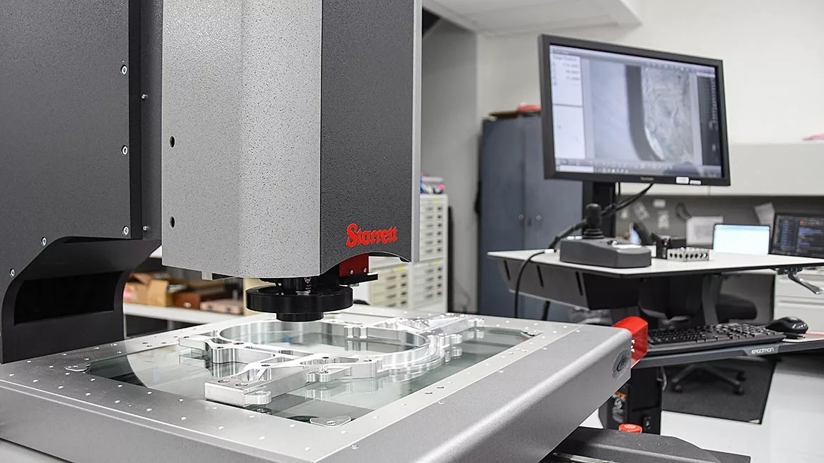

English said, “The Starrett vision system was able to measure the bushing undercut in an accurate, efficient and timely manner.” Osborne agreed: “When it comes to checking the small radii, the vision system is far superior to traditional touch trigger CMMs. Multiple optic zoom levels allow us to clearly see the tangent lines of the radii, giving our machinists critical feedback on challenging features.” Osborne also noted that alternatively they could have used an optical comparator to measure the bushing, but the vision system is superior in terms of speed and ease-of-use.
“The speed and ease of use allowed us to quickly determine what machine adjustments were needed. The vision technology allows us to measure the size of the undercut as well as pick up on any small mismatches we had on the flange,” Osborne continued.
For measuring the shim, the benefits of using the vision system are just as impressive, especially for achieving accuracy and repeatability. The camera on the vision system focuses on the part without needing to touch it, ensuring that the dimensions are within specifications. Osborne said, “By using the vision system, we eliminated the need and time for a CMM to check the part. Also, we no longer need to use manual measurement methods to check the OD, which removed operator error.” Since obtaining accurate OD measurements on thin shims by using a CMM or micrometer can be challenging, the vision system provides several benefits. Results are repeatable, and RYMS can quickly select measurement points across the entire OD of the part, ensuring comprehensive data results.
Setup time has been reduced, part quality has been enhanced and delivery times are being met. Osborne said, “The AV450 is saving time inspecting the first piece by obtaining good measurements right away, instead of having to go back and forth with production on whether the dimension is good or not. We have saved hundreds of hours since implementing the system.” At annual part volumes of over 12,000 for both the shims and the bushings combined, getting the job done correctly right out of the gate is a tremendous win for RYMS.
