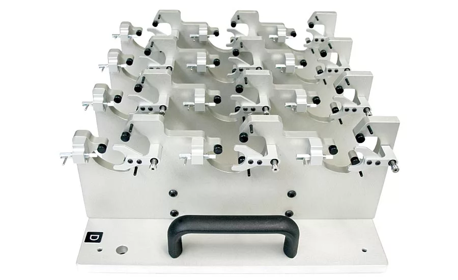

Custom CMM fixture
Custom CMM fixture to hold 12 parts. Parts are elevated above the base allowing access to the probe for under part profile checks. Part locates against locator pins and is held in pace with a forked down-force spring clamp. Source: Renishaw

Within a metrology inspection environment, fixturing is a three-step process of positioning, locating and securing a workpiece within a measuring volume for inspection. Whether this inspection involves a coordinate measuring machine (CMM), vision machine or flexible gaging system, the goal of the fixture is to hold the part securely and repeatably. A well designed and manufactured fixture will remove operator variance and help to ensure consistency of inspection.

Fixture repeatability is a significant factor when considering the consistency of metrology data, which is especially important in high volume, large batch inspections. A correctly engineered metrology fixture can ensure positional repeatability. Although many modern inspection machines can mitigate micro alignment and workpiece positioning errors, large discrepancies in part positioning can result in unnecessary rejections and metrology data errors. Efficiency is also compromised with operators ‘looking for’ or locating part datums relative to the fixture prior to inspection. Therefore, a fixture needs to be sufficiently repeatable to ensure that a workpiece can be removed and replaced without fluctuating datum features.
