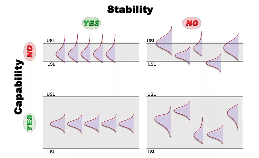

Misunderstanding the purpose of SPC frequently derails well-intentioned efforts to implement it.
Some manufacturing personnel falsely believe that SPC charts are meant to indicate whether products will meet specifications.
Rather, SPC charts tell us when the system has changed, so we can quickly identify the causes and potentially prevent an issue or make an improvement.
1.ENSURE THAT THE PURPOSE OF SPC IS CLEARLY UNDERSTOOD
Misunderstanding the purpose of SPC frequently derails well-intentioned efforts to implement it. Some manufacturing personnel falsely believe that SPC charts are meant to indicate whether products will meet specifications. Rather, SPC charts tell us when the system has changed, so we can quickly identify the causes and potentially prevent an issue or make an improvement. These can be changes that are still within specification—but are statistically different than where the process was previously running. By identifying the changes, we can identify what caused the change and potentially improve the process or prevent the production of inferior products. Note that the appropriate method to assess whether the products will meet specification consistently is Process Capability Analysis (provided that the process is stable).

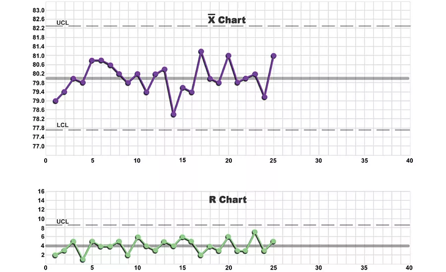

5. UNDERSTAND THE DIFFERENCE BETWEEN CONTROL LIMITS AND SPECIFICATION LIMITS
Control limits represent the range over which we expect statistics, such as process averages or standard deviations, to fall. When these process statistics fall outside the control limits, we conclude that a process change has occurred. On the other hand, specification limits are limits of conformance pertaining to individual values such as a part dimension or material properties. Control limits should only be determined by actual process data whereas specification limits are determined by an engineer, designer, or customer. Manually “assigning” control limits should only be permitted when based upon the process data, otherwise the control chart will result in inappropriate chart signals or a lack of appropriate chart signals. Finally, specification limits do not belong on control charts. Because averages have considerably less variation than individual measurements, they cannot be compared to specification limits which are typically intended to apply to individual measurements.

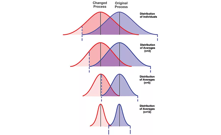

7. SELECT THE RIGHT SAMPLE SIZE
Sample size refers to the number of measurements taken within each subgroup. Charts of averages have the ability to vary their sensitivity to detect process changes based upon the sample size. Small sample sizes, such as individuals charts where n=1, lack the power to detect small process changes. On the other hand, excessively large sample sizes can result in control charts that indicate instability even when the process change is not of practical concern.
Many people involved in designing control charts have little understanding of the impact that sample size has on the ability of the chart to detect process changes. The reality is that the sample size can have a dramatic impact on whether signals are obtained for a given process change such as a mean shift. Before we design a chart, we should have some idea of what degree of process change we would want to detect if it occurred. Usually this depends on how much variation we are willing to tolerate and how capable the current process is. For instance, a highly capable process probably won’t need as much sensitivity as a borderline capable process.
Selecting an appropriate sample size allows a control chart to produce signals when we need them and minimize the chance that we’ll be alerted of changes that are of little or no practical significance. Note that the sample size may need to be modified over time to reflect process improvement or process degradation.

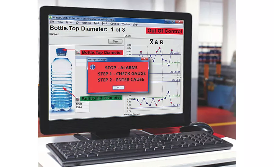

8. AUTOMATE SPC TO REDUCE COST AND IMPROVE PROCESSES
Statistical Process Control is most effective when applied as close to the point of production as possible. If sampling and charting is performed after the end of a run, discovering that the process was not in control after-the-fact may prevent a questionable shipment, but the cost of additional inspection, scrap and/or rework is already generated. With automated, in-line SPC systems, control tests can signal operators of a problem and prompt action to address special cause variation before the manufacture of nonconforming product. By providing real-time feedback, automated SPC systems become preventative, rather than merely reactive, monitoring tools. Automated SPC systems also reduce the opportunity for human transcription error and ensure that control test rules are consistently applied and alarm conditions are recorded for further investigation.
