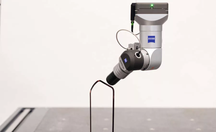

“Applications fit into several categories,” Wick says. “The first is e-motors, for measurement of the shape and insulation of the hairpins going into an electric motor. There we have to use a CMM with a noncontact optical sensor to measure the shape, and measure the thickness of varnish next to the wire.”
