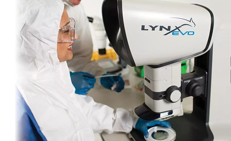

eyepiece-less stereo zoom microscope
An eyepiece-less stereo zoom microscope. Courtesy of Vision Engineering

The exit pupil in eyepiece-less microscopes is about 10x larger than binocular microscopes and is further from the instrument. Since there aren’t any eyepieces, the user’s eyes are several centimeters from the equipment. With the larger exit pupil in eyepiece-less microscopes, the user can be positioned further away from the instrument, reducing the risk of cross-contamination and allowing for the use of protective eyewear or glasses without impacting the field of view. A larger exit pupil also means users are not in a fixed position when using the system and lateral head movement is possible without affecting the field of view (which enhances the 3D quality of the image).
