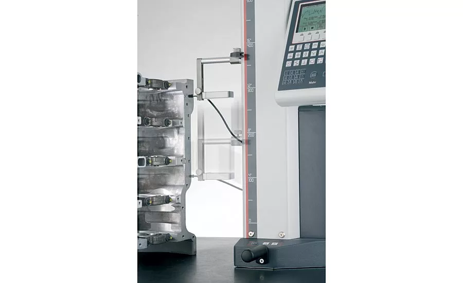

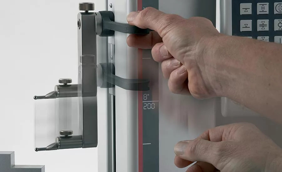

height probe
Simply by starting the probe towards the surface to be measured can initiate a measurement.

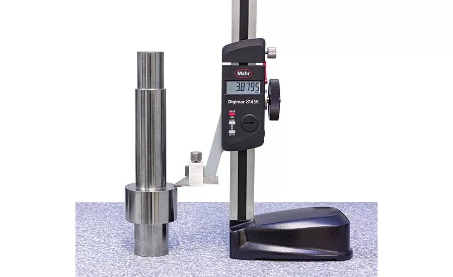

scribing height gage
A scribing height gage can be used to scribe a dimension on a part to be machined or used as a simple length.

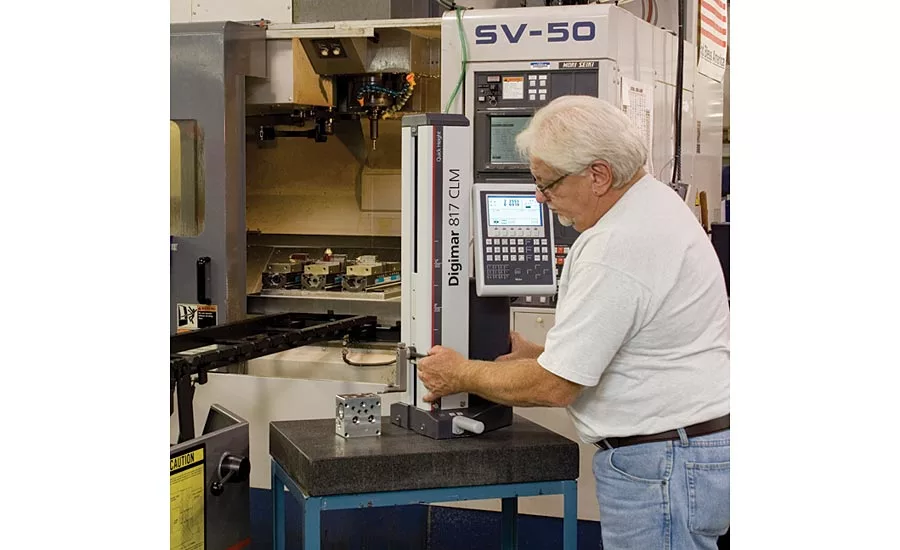

height gage
While a height gage can be used at the point of manufacture, it is important to ensure that the surface plate is clean and within tolerance, as it sets the reference for the measuring system.

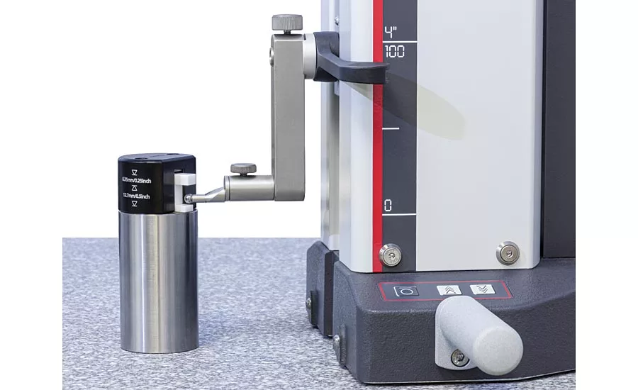

setting standard on a height gage
A setting standard is used to calculate the ball diameter of the measuring probe to allow for upward and downward measurements.

The height gage is a conceptual extension of the handheld caliper gage, except that it rests on a heavy base that keeps the scale square to the surface. Height gages have a beveled pointer on the moveable jaw that can be used to mark or scribe the part. Alternatively, by setting the reference height on the base surface, the scribing point can be used to find a height characteristic on a part and display it on the gage’s readout.
There are four types of basic height gages. The classic Vernier height gage has been around for close to 100 years and is still used by machinists who feel really comfortable counting the grads to make sure their readings are correct. The circular scale height gage uses a dial indicator to set the measurement height. The digital height gage is a relatively recent addition that allows for direct reading of the height. Today, there are also electronic height gages with motorized drives that are capable of making various direct length or even 2D relationship measurements.
The first three height gages are primarily used for the layout applications mentioned above, setting heights to scribe a part or height measurements. However, for inspecting parts, an electronic height gage is the tool of choice due to its versatility and direct-reading measurement capabilities.

A bad reference is also a concern for a height gage. Most height gages are used with a surface plate. The surface plate provides the reference for the part and the height gage. Many surface plates are clean and well maintained, but there are those that may not be as clean as they look. A small metal chip or even a hair, while almost impossible to see, could throw off the measurement by parts of a micron at a height of only 250 mm.
Next to dirt, the actual granite surface of the plate will play a key role in the performance of the gage. Any slight imperfection between where the part and the gage are staged will be amplified the higher the measurement. For example, most surface plates have a flatness spec of 1um. If the base were 150 mm long, a 1um error would grow to more than a 6um error in 1000 mm, and even worse if the plate were out of spec.
Furthermore, height gages are direct reading measuring instruments (they have the reference scale built in) so they are especially susceptible to variations in temperature. Behind dirt and mechanical issues with set up, temperature is a significant influencing result. Since the body heat of the operator is clearly above room temperature (20 º C), any heat conveyed to elements of the measuring circuit (base plate, test piece, height measuring instrument, stylus) could cause local heat expansion and induce measurement errors. As a result, operators should be very careful in observing the following rules:

The other important reference is the correction for probe ball diameter. If a height gage is to be used only for length measurements taken with the probe moving down, then probe diameter is not important. The contact point of the probe will be the same as in zeroing. But, if grooves, diameters, or hole locations are being measured, or if any measurements are taken with the probe moving upwards, then the probe ball diameter must be known and taken into account.
Ball diameter is specified for the probe, of course, but there is always some degree of variation. Actual ball diameter should be added to any dimension that is probed in the upward direction.
On height gages that have even the most basic electronic control this dimension can be measured as part of a set-up routine and is automatically included in all measurements. The automated process uses a fixture provided with the gage, or the test can be simulated with a couple of gage blocks. The fixture sets up a plane that is measured by the gage from both directions. The gage then looks at the difference between the two measurements and calculates this as the ball diameter.
The same gage block check can be done by hand on manual machines or the ball diameter may be measured off-line with a micrometer. Just as with setting the zero reference, this check should be repeated a number of times. Many gages will provide this repeat check automatically and reject the ball diameter reference if it does not repeat to within a preset limit.
Additionally, failing to recheck for ball diameter can be a deadly pitfall when a probe tip is changed. Going from a 10- to a 5-mm ball tip would be disastrous if not recalculated.

Since the gaging probe is motor driven, electronic height gages employ automated gaging routines to make dimensional measurements. Typically, there will be an icon representing the measurement to be made. Making a simple length measurement from above is done by raising the measuring probe above the part, bringing the arm into position below the part and selecting the “down measurement” icon. The gaging is being done in this automated measurement by driving the probe down onto the surface by its motor drive and once the part is touched (with the probes programmed speed and gaging force) it retracts and is ready for the next measurement.
Today’s electronic height gages will have similar icons for up measurements, slots, diameters and ID or OD radii. The difference with these diameter checks is that the part, or the gage, will be moved to “sweep” the diameter to find the high or low spot dynamically.
New features allow for making down or up measurements without the need for even selecting the measuring icons. By placing the probe over the part and starting to slide the probe arm down, the electronics sense a start of the measurement and will start the motor to make the down measurement. On a part with multiple length measurements, this can be a major saver for the operator.
