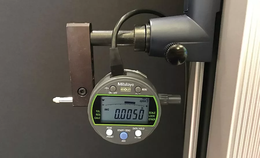

Straightness/squareness: Some height gage models have the capability of inputting the output from linear displacement devices such as indicators. Due to this input, displays are capable of showing straightness, as well as squareness due to the high tolerance squareness specification of the gage.
