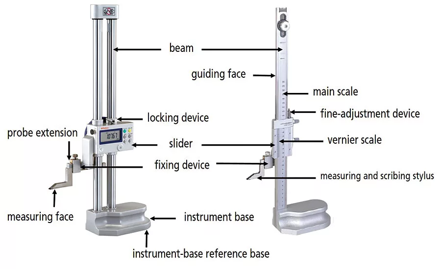

A height gage does exactly as its name indicates—measures the height of a workpiece. A height gage is a measuring instrument in which a slider with a measuring stylus moves relative to a measuring scale on a beam and in which this motion is along a single vertical axis nominally perpendicular to a reference plane on the instrument base.
Height gages are normally used on a granite surface plate to measure and/or scribe part features from a datum plane. Generally a scriber, test indicator, touch probe or CMM-style probe is used to locate the measured feature. Height gages are an indispensable instrument for quality control.

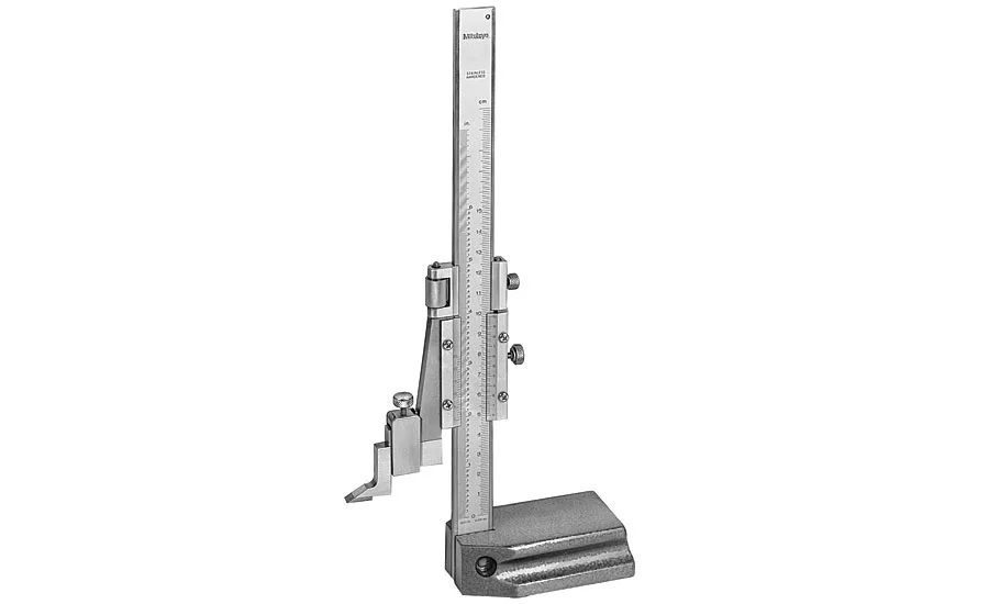

Mechanical height gages have been used in flat plate layout for many years. There are three basic types of mechanical height gages:
  1. Vernier height gages are available from six inches to six feet in height, a chief advantage over other height gages. It can have one or two (both inch and metric) scales on the beam.

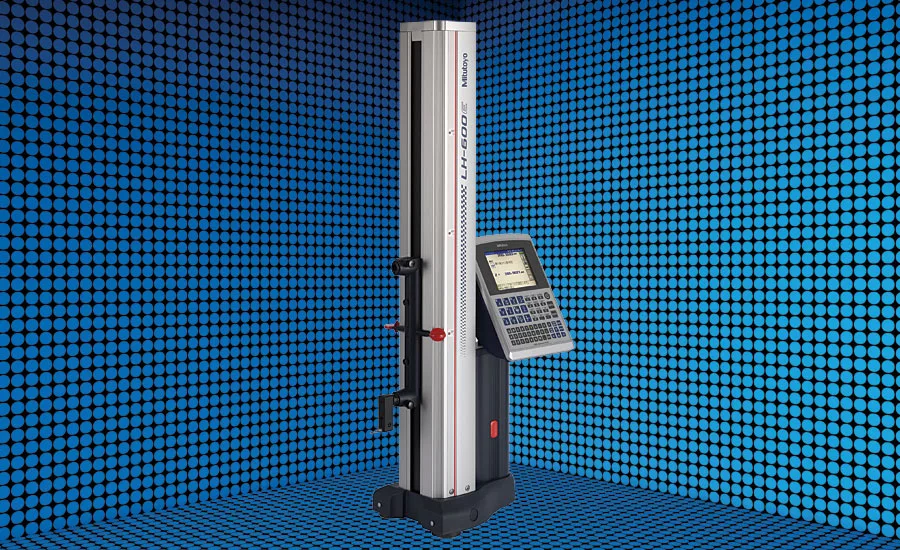

Electronic height gages can be divided into three distinct groups.
The first group has accuracies similar to mechanical height gages. Generally, they will have inch/metric conversion, absolute zero and floating zero, and data output.
The second group includes all of the first group features, however, the accuracy of the tool is a magnitude of order better and may have additional features, such as tolerance setting, ID/OD measurement, max/min, TIR and probe compensation.
In general, the last group has all the features of the second group and a higher accuracy rating. Most height gages in this class will have air bearings, a motorized touch probe, the ability to generate and store part programs, and a computer interface, allowing for SPC. They also can measure a part feature in two dimensions by rotating the workpiece. Use these height gages when higher accuracies are required, or to help reduce the demand on your CMM.
