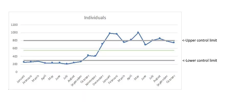

A company was recently tracking defects in production on a run chart. The chart demonstrated a huge spike in reported defects and, if the observer had not known better, it would be easy to conclude that the wheels had fallen off the bus. This was a case where calling in the cavalry could have been a justifiable reaction (and many were prepared to do so), however, it was revealed that “anonymous reporting” was implemented around September, which explained the spike. “We finally knew how many defects were really out there,” said the COO, delighted that while the defects were unfortunate; they revealed the quality improvement imperative that was hiding in plain sight.

When seeking special cause variation, we often only see those data points at the extreme, like those that appear above the control limits in the chart above. But shifts, cycles and trends are also examples of special cause variation. According to the Western Electric rules, this includes 4 out of 5 consecutive points on the same side of the mean and at least 2 standard deviations from it, or 8 consecutive points on one side (rules 3 and 4). The complete rules are not much more complex than this, and can bring perspective to what is really happening in a process being monitored.
