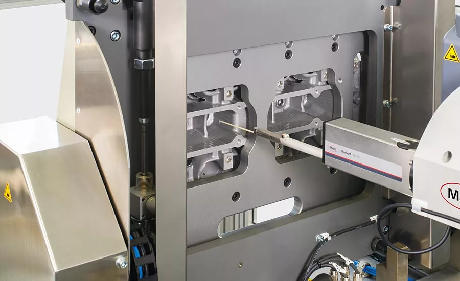

A fully automated surface measuring process is the ultimate custom gage solution. It takes the operator completely out of the picture and can run unassisted in a very reliable manner moving, manipulating and measuring the parts.
There are two levels of custom gage automation involving part movement within the gage. The surface measuring system can be designed for an automated process as a standalone station. Alternatively, the surface system can be a component of a dimensional gaging station where the part is presented to the surface gage for measurement, controlled by the PLC system running the whole gaging station.
Surface systems designed as standalone stations are often robot fed and may or may not include part manipulation/movement. Standalone stations have all the gaging components in place with the measuring system sending information back to a main PC running the surface system, changing probes and any movement of the axis to position the surface probes. This type of system has a customer program that knows the various parts to be measured and uses sensors to verify when a part is in place, when to take a measurement, and when to provide gaging results for disposal. These custom solutions are specifically tailored to the speed of the process, the part tolerances required, the environmental conditions of the process, and the capabilities of the system that is bringing the part to the gaging station.
Figure 4: A fully automated surface inspection system takes complete control of the process—part positioning, probe selections and feature measurement. Source: Mahr
