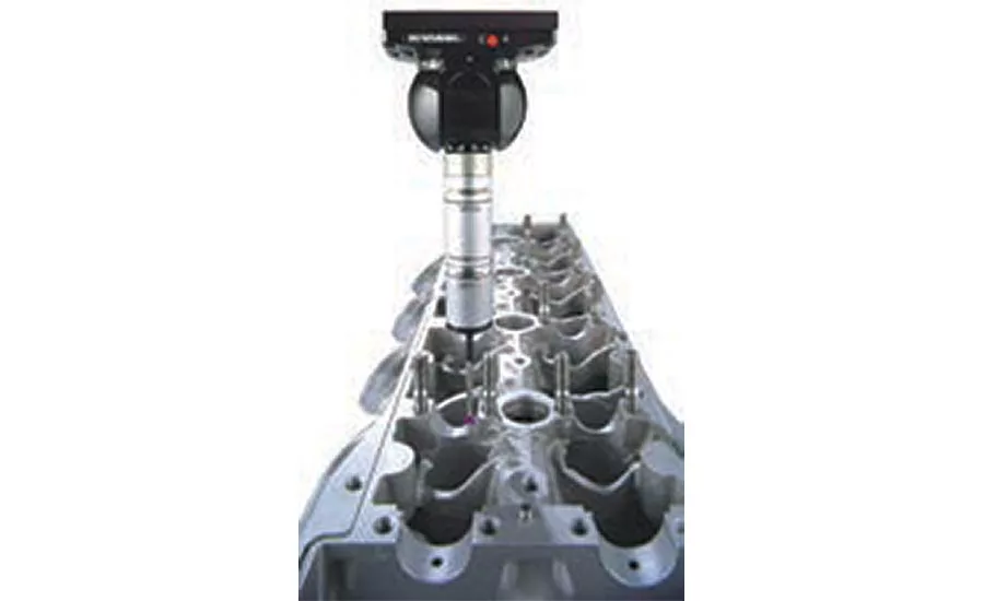

QTY Measure B: CMM Measures Engine Head Multiple Surfaces. Source: Mitutoyo
A 5-axis probe provides faster measurements of parts with many different dimensions, eliminating the need for switching probes or using multiple machines for accurate results.

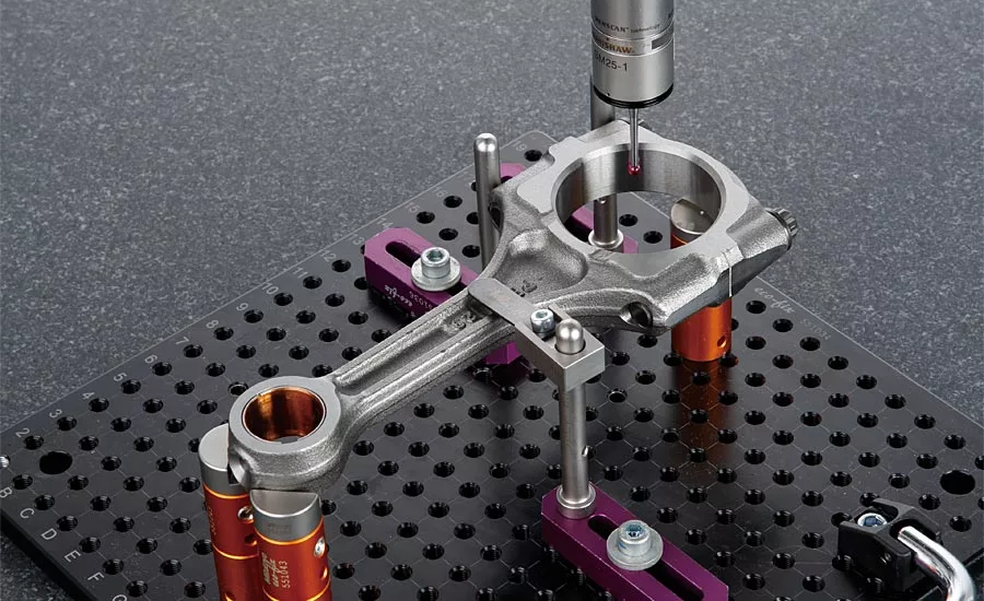

QTY Measure B: CMM Measuring Piston Rod. Source: Mitutoyo
A 5-axis CMM measures an automotive piston ring, providing many different dimensional measurements on one machine, including inner diameters, steps, bore depths and even roundness, something that would have required multiple machines in the past.

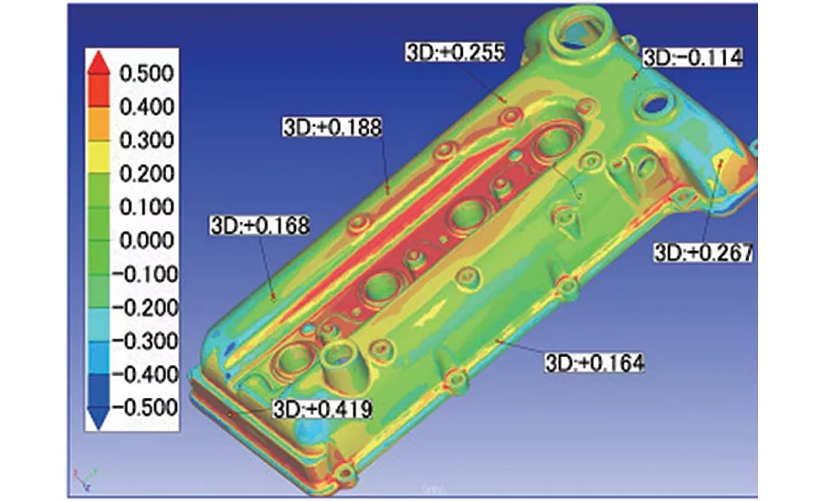

QTY Measure B: 3D Model of Valve Cover for CMM Measurement. Source: Mitutoyo
New CMM software can take a CAD model and automatically generate the part program needed, making part measuring even faster. With this, you can have the CMM ready to measure parts long before the first pieces are manufactured.

5-axis rapid touch trigger measurement is considered the next step below constant contact and drag scanning measurement because it measures individual touch points by physically touching a point to measure it in rapid succession. This is accomplished by the probe head itself moving while taking point measurements.
When compared with conventional probing, 5-axis rapid touch trigger measurement is much faster. It can reduce measurement time 60%-70%, depending on what is being measured. And when compared to a regular CMM machine, 5-axis rapid touch trigger measurement offers benefits in certain measurement situations. For example, when measuring a part that has many holes and many points in each hole, this is an ideal application for 5-axis rapid touch trigger measurement as well as when measuring complex surfaces with tight access (e.g., an impeller for a turbo system). The ability to infinitely position the probe head at any angle allows access to areas that a traditional fixed probe head could not reach.
Mostly, anything that a conventional CMM with a fixed probe can measure, 5-axis rapid touch trigger measurement can also measure because it’s a better alternative when it comes to ensuring measurement flexibility, especially since standard probing systems are restricted in terms of the angle that you can set.
Some motorized probe heads have fixed angular degree increments, and you can’t set an angle between the fixed angular increments. With 5-axis rapid touch trigger measurement, however, you can achieve infinite positioning of probe heads at any angle. This is because a 5-axis head can move the touch probe independently, instead of the probe being stationary and the entire CMM machine itself having to move.
This increases speed and flexibility of measurement, as well as accuracy. Why? Because it makes a difference if the machine is moving vs. whether the probe is moving. Forces generated by the movement of the machine can negatively impact measurement accuracy. The extended reach of a 5-axis touch probe could positively impact accuracy given you’re not limited to the effective working length of the stylus itself to determine how far you can go down into a hole to complete a measurement.
In addition, in terms of flexibility, you can do five-axis moves, with the ability to move the machine and rotate the probe head at the same time. This means you are not limited to the CMM measuring volume with the additional length of a fixed probe system. For example, if you are near the limit of your machine measuring volume and you need to clear a surface and then drive down deep into a bore, with 5-axis rapid head movement you could plan an arc path so both the CMM machine and 5-axis probe head move synchronously together to give you the needed clearance to accomplish this measurement.

Working With An Automated Parts Programming Tool
With Model-Based Enterprise being developed and integrated within product design, this information can be pushed downstream to be used for automated parts programming. Once you have the PMI (Product Manufacturing Information) information annotated onto the 3D model, you load the CAD model file into the CMM software, even if it’s a 5-axis rapid touch trigger measurement system, that you will use to measure the part. It will automatically generate the part program needed, with all moves, measurements and tolerances, in advance.
This makes measuring the part even faster, as well as the result. Typically, days’ worth of programming time can be reduced to minutes, or at least significantly reduced when compared to sitting at a CMM and programming from a blueprint, depending on how well the annotated models come in with the necessary information. Using automated parts programming, a program could instead be automatically generated and ready to run on a CMM within an hour. This frees up valuable machine time and valuable programming time. A simulated program can be posted down to the CMM when the part is ready, so you have all the information up front and can have the CMM ready to measure parts long before the first pieces are manufactured.
