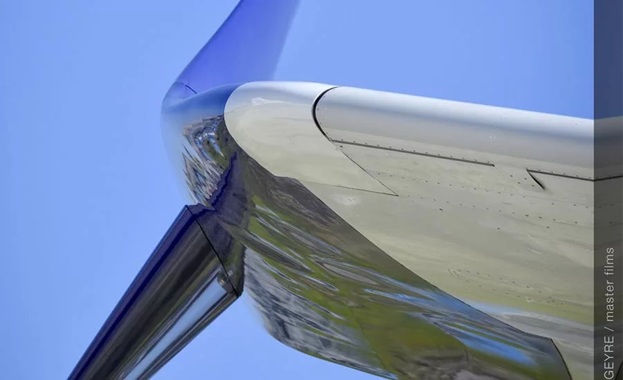

QTY July 2021 NDT in Aerospace Winglets. Image courtesy of Airbus
Near-vertical winglet of an Airbus A380 illustrates the design freedom carbon-fiber structures can achieve in pursuit of improved drag efficiency. Image courtesy of Airbus

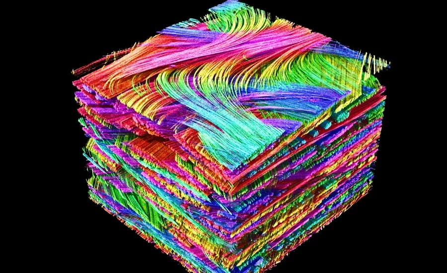

QTY 2021 NDT in Aerospace Faser Wuerfel 2K. Image courtesy of IAM-WK/KIT (Institute for Applied Materials/ Karlsruhe Institute of Technology), Germany
Orientation analysis carried out on a glass-fiber-reinforced sheet-molding compound (SMC). Each direction is coded by a certain color. This orientation data can be used to obtain fiber orientation distributions over the thickness to validate flow simulations and to provide reliable data for the structural simulation. Image courtesy of IAM-WK / KIT (Institute for Applied Materials/ Karlsruhe Institute of Technology), Germany

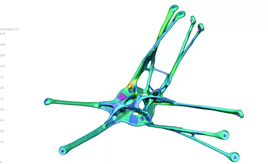

QTY July 2021 NDT in Aerospace Topology Image. Image courtesy Volume Graphics
CT-data analysis and visualization software wall thickness analysis (WTA) on a topology-optimized, 3D-printed satellite bracket. The WTA shows the distribution of different wall thicknesses throughout the part. Image courtesy Volume Graphics

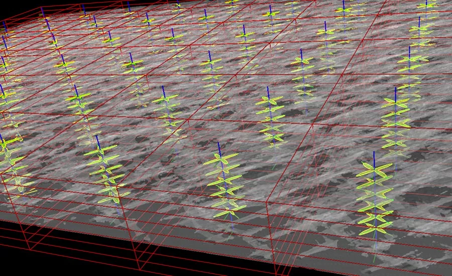

QTY July 2021 NDT in Aerospace Local Orientation Histogram. Image courtesy of Volume Graphics
Local orientation histograms of a woven fabric are shown in yellow. Using the principal orientations of these histograms allows engineers to measure the local shear angle of the material after the draping process. Image courtesy of Volume Graphics
