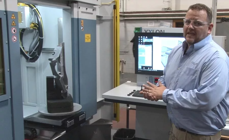

Chris Cherry, YXLON application engineer manager
Chris Cherry, YXLON application engineer manager, performs an inspection scan with YXLON MU60 AE.
