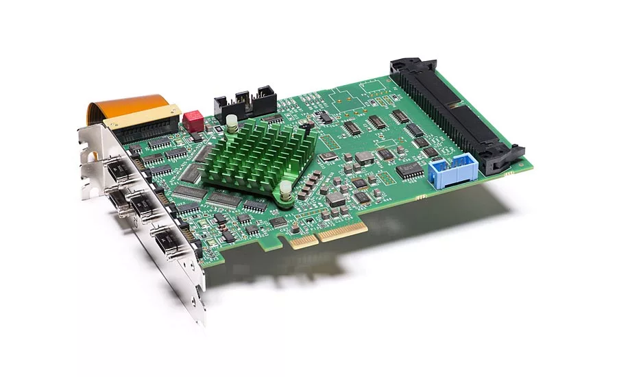

This Camera Link frame grabber supports up to four cameras running independently or synchronized. All Images Source: BitFlow
