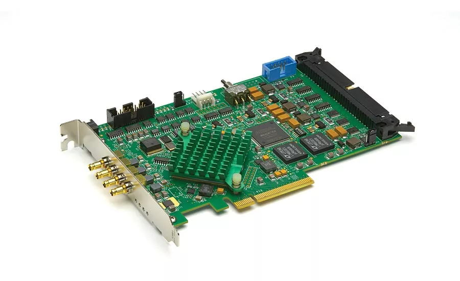

A CoaXPress frame grabber (Cyton CXP4). Source: BitFlow
