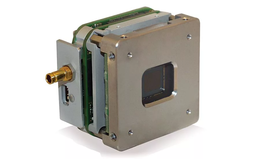

These cameras provide excellent imaging from low to high light scenes
These cameras provide excellent imaging from low to high light scenes with optimal contrast reproduction. The CoaXPress interface ensures easy system upgradability to new resolutions and sensor technologies.

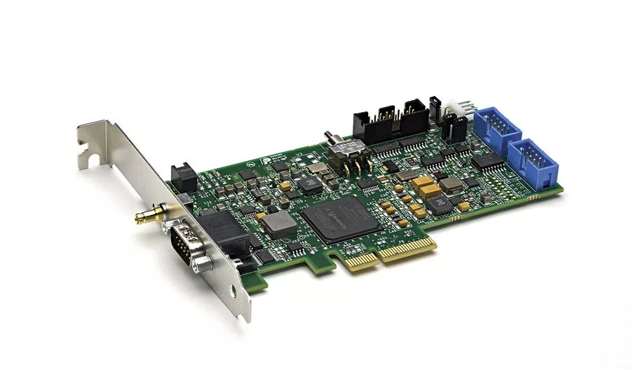

This is a low-cost single link CoaXPress frame grabber.
This is a low-cost single link CoaXPress frame grabber. While it looks tiny, it supports CXP camera speeds up to 6.25 Gb/S. When used with a single link CXP camera can get almost twice the real world data rate of the USB3 Vision standard and significantly quicker than the latest GigE Vision data rates—up to 2 MP images at 300 frames per second.

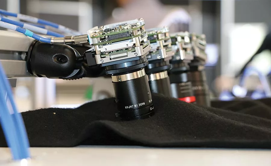

Here is a camera application shot of a CoaXPress system. Source: Adimec
