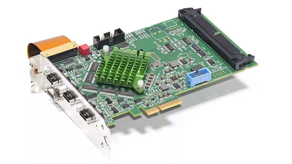

VS 0124 Standards feature BitFlow Camera Link Frame Grabber
Source: BitFlow
