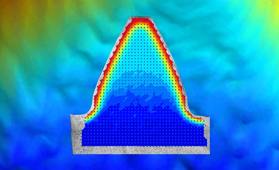

It’s now possible to ‘scan’ a sample and create a collage of indents to provide a wealth of detail on material hardness variation. The hardness map created literally adds a new dimension to any test data, providing a quick qualitative assessment of the heat treatment process, with the detailed quantitative data available if closer inspection is needed. Figure 4 shows hardness mapping of a gear tooth, allowing us to instantly see the depth of hardness penetration, and visualize any problems. This may not always be necessary in a quality control environment, but for development, failure analysis, setting up a new manufacturing process or for highest specification quality control this kind of analysis can be invaluable. The ability to visualize the hardness map, set maximum and minimum hardness values, and quickly identify anomalous indents makes these programs highly user friendly. Other tools help users conform to ASTM and ISO specifications. For example, virtual indent size overlay allows a user to easily assess minimum indent spacing compliance.
Figure 4: Hardness mapping on a gear tooth (a) 2d and (b) 3d
Figure 4: Hardness mapping on a gear tooth (a) 2d and (b) 3d. Image Source: Buehler (Click on image to enlarge.)
