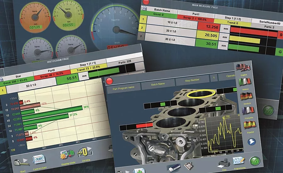

QTY 1021 Software & Analysis: Merlin Plus SW3
Image Source: Marposs
