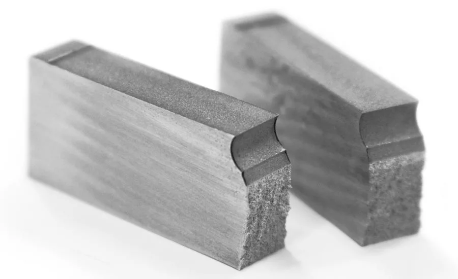

QTY 1121 NDT Back 2 Basics: Fractured Bend Specimen

The main test is breaking a notched specimen in tension – seemingly straightforward, but this is not equivalent to impact toughness tests (Charpy or Izod) routinely carried out using a basic machined specimen. In order to get an accurate value, the notch must be “sharp” right down to the atomistic level! This is achieved by fatigue pre-cracking, that is to say applying a cyclic force for many thousands of cycles, which will grow a crack into the specimen, from the tip of the machined notch. Data from this process must also be recorded as it will be used later on in the analysis.
After the test, the calculation of a fracture toughness value (KIc is typically given in MPa√m or ksi√in) requires inputs of a physical measurement of the crack front before fracture, and determination of key characteristics on the force vs. extension plot. An equally significant part of the post-test data processing is to perform a number of calculations to confirm the validity of the measurement.
