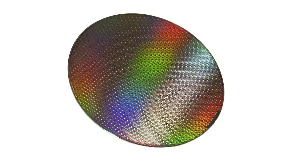

QM 0222 Test & Inspection: Pixels Figure 2 - Silicon Wafer.
Figure 2 - Silicon Wafer. Photo by Rob Bulmahn, Creative Commons License
What motivates smaller pixels? It’s mainly cost, which is directly tied to image sensor size.
A processed 300mm wafer costs between $4,000 and $14,000 depending mainly on the “node” or how small the features can be. The node ranges from 45nm down to 5nm with smaller node processes costing more. It also depends on the number of process steps needed to fabricate the wafer. Also, wafers are processed in lots of at least 20 wafers.
To gain economy, it becomes necessary to increase the number of image sensors per wafer. The easiest way is to make the image sensors smaller.
