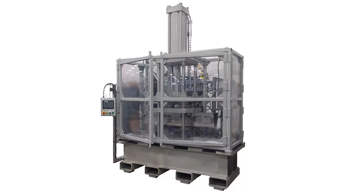

Finally, Donald Engineering’s Kortman made the client a proposal. “I said, ‘How about we help you build your own – to your needs? We’ll do the hard stuff, and your team can do the basics of the machine assembly.’ Because of their fabrication capabilities, it wasn’t hard for them to create the machine to the specifications they wanted. We helped them build the first one, which worked very well. So, from there this approach evolved into multiple copies with some design revisions to add capability for new products.”
QM 0222 Case Study Custom Crusher 1
The resulting four-post press featured a machine-control HMI on its top, control buttons, a load cell at the bottom, a press frame, press guidance, a cylinder, a feedback device within the cylinder, a hydraulic proportional valve, and a Delta Computer RMC75 motion controller configured for one output axis and inputs for displacement and force. The apparatus must move slowly and very consistently, so the positional control provided by the Delta RMC was critical.
To create its custom press, Donald Engineering leveraged its wide portfolio of hydraulics suppliers to provide the right components, such as cylinders manufactured by Milwaukee Cylinders and power units from Continental Hydraulics. This ability to select the ideal component for a specific task is an important benefit of having a hydraulic distributor such as Donald Engineering, which also offers design, engineering, and programming services.
Subsequent press designs included high-resolution cameras and dual load cells to show variance in crush forces for each side. The load cells were built on the same axis as the component, hung just below the press bearings and press guidance, with each feeding data back to the RMC75. These were necessary because if one part side started to wrinkle before the other one, the load cells would keep the press platen from canting or skewing to one side. Also, the client wanted to measure the applied force as the opposite side deformed.
Kortman estimates the client saved 30% to 50% off the price of buying an off-the-shelf tester and ended up with the exact solution they needed. He notes that not every company has its own internal machine build group, so savings will vary widely by customer. Also, says Kortman, this customer was able to utilize its own PLC programming capabilities, which helped to shorten the machine development. Kortman refers to the Delta RMC as the solution’s “key,” without which “machine control and data acquisition would have much more difficult to execute. The Delta made this almost child’s play compared to the programming” that would have been required using other control equipment.

From start to finish, the crush tester took roughly 15 weeks to complete, and that was “working at it quasi-part time.” Two weeks of that involved programming and debugging. According to Donald Engineering, Delta Computer’s help was key in making the configuration process quick and smooth.
“For example,” says Kortman, “Delta helped with some of the Visual Basic integration. We knew how to code and do VBA, but we still had questions: How do we get this or that from the data? How are we going to filter it? Where do we filter it? Delta came in with a lot of advice and coaching on how we could do things better.”
The VBA integration was important for automatically porting the crush data into the client’s cloud. The Delta controller provided all the data points in Excel format, then Donald Engineering’s VBA implementation turned that data into display and controls. In turn, this was turned into a PDF for cloud uploading. All of the “gargantuan” source Excel data (potentially 32 million data points), even down to the seventh decimal place for displacement and fourth decimal place for newtons of force, remained available for anyone who wanted to micro-analyze the crush characteristics.
“The machine slowly works through the simulated situation,” explains Kortman. “And all the time, we are recording the distance — the position — and the average force reported for the two-load cell system. That data gets captured into the data file. We also have the total force, not the averaged force, captured for the single-load cell setups. We’re closing the loop on velocity and deriving energy absorption over time and distance. From all the captured data, we get a graph, and that graph has to fit the end energy absorption requirements.”
