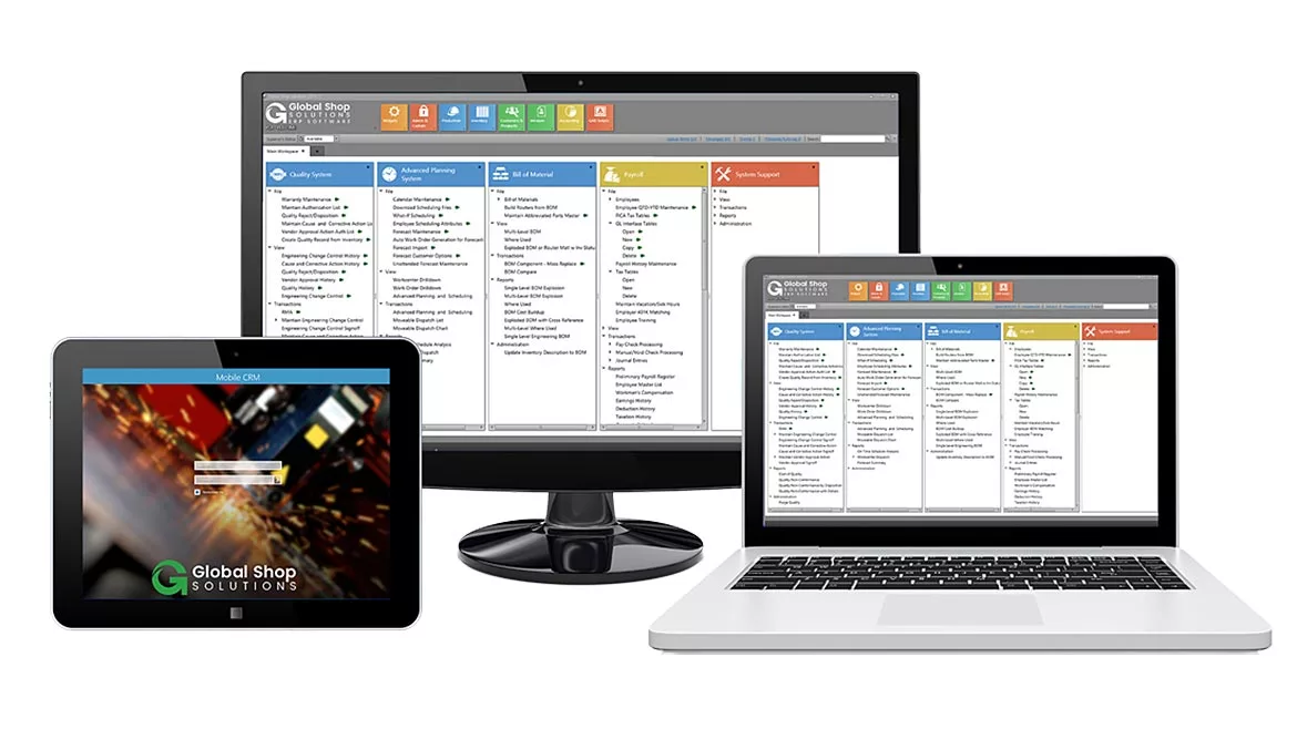

Track, capture, and resolve real-time quality issues with ERP software. Source: Global Shop Solutions
