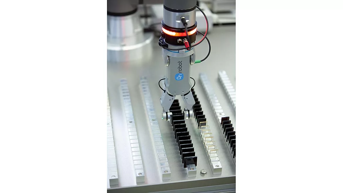

It’s worth noting that the gripper SCHOTT selected came with both force/torque sensors and optical sensors located in its fingertips. The sensors feed process data back to the robot arm, which can adjust its course as required in real-time, enabling the gripper to precisely control the forces applied. It also provides the sensitivity required to load the spectrometer with millimeter precision. In addition, the gripper’s fingertips are customizable; SCHOTT coated them with foam to ensure it gripped the glass samples perfectly every time. | Image Source: OnRobot

This was the case with SCHOTT, a global leader in specialty glass and glass ceramic products, that faced a threefold increase in the volume of samples for inspection. Manual inspections were taking anywhere from 3-15 minutes, each inspection took a lab technician away from other tasks, and SCHOTT needed a quick and effective way to increase capacity.
With limited space available in its inspection laboratory and human lab technicians in the same workspace, traditional non-collaborative industrial automation was out of the question.
Another complication centered around the extreme sensitivity of the company’s transmission spectrometer – a measuring device that’s used to record the optical properties of glass. This requires automation with extremely sensitive grippers that can insert and remove samples without causing any damage to the spectrometer’s delicate insides.
The company successfully deployed collaborative automation, consisting of a collaborative robot arm and an electric, two-finger collaborative gripper, to run at night and over the weekends, enabling SCHOTT to meet the 300% jump in inspection requirements and freeing its lab technicians to focus on other work.
Not every collaborative gripper comes with that level of intelligence or customization, so make sure to do your due diligence when researching your gripper options. Ensure compatibility with your existing automation to reduce deployment times. And make sure to explore the support and training offerings that come with your gripper.
