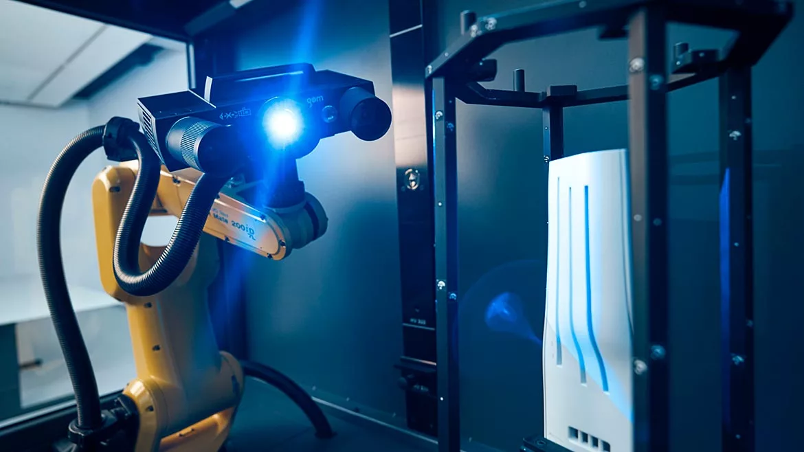

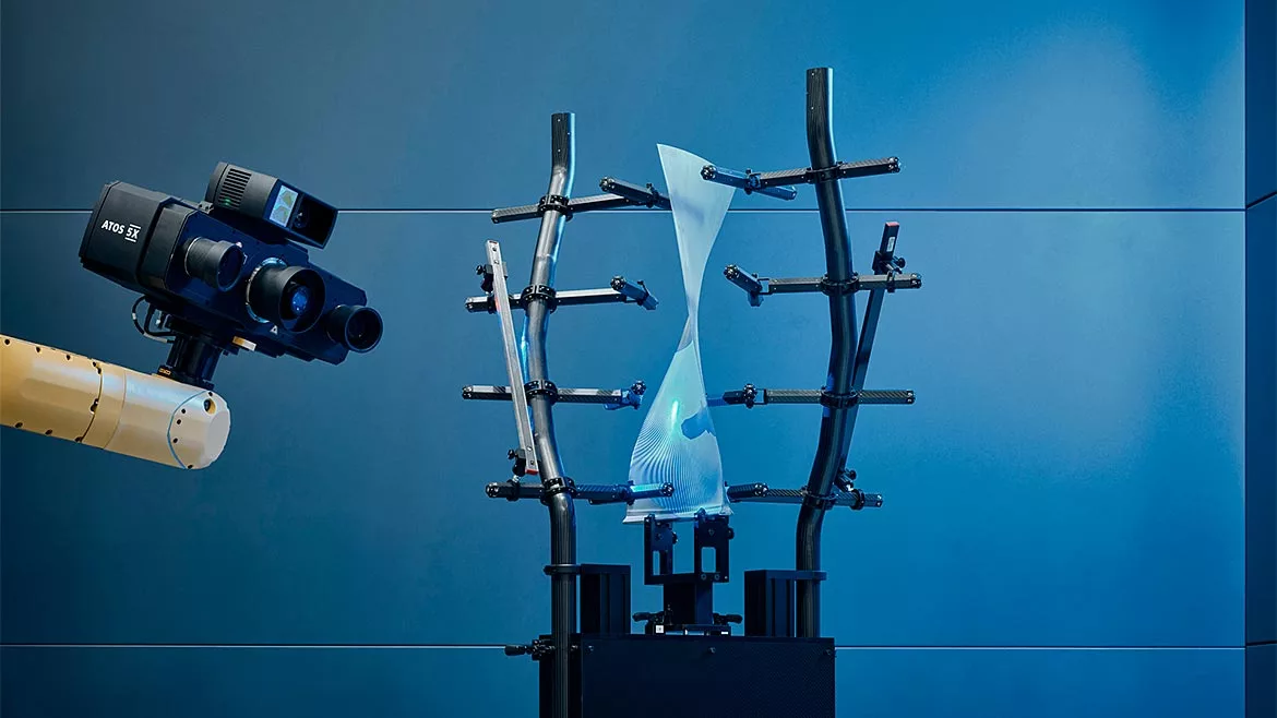

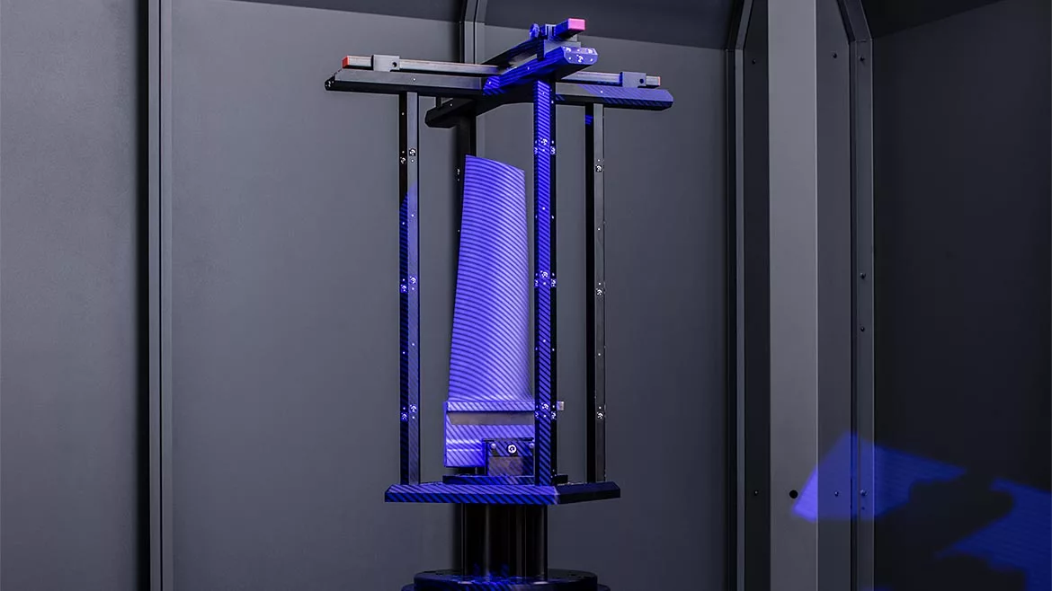

ATOS blue light 3D scanners quickly collect complete 3D measurement data from the surface of a blade. | Source: CAPTURE 3D, a ZEISS company

Another alternative to destructive testing for coating thickness analysis is the use of test coupons as standardized specimens that allow the analysis of localized data from a few areas of a blade. The test coupons are sent to a lab where technicians evaluate the cross-sectional thickness of the coatings. The lab’s analysis indicates the appropriate modifications to the coating application process. This process is repeated until the allowable thickness is achieved. One iteration of a coating project can take six weeks, and with some projects requiring multiple iterations, this becomes a lengthy development process. However, an accurate 3D scanner offers a fast and efficient alternative method of measuring blade coating thickness. Instead of waiting weeks for analysis from a lab, a 3D scanner collects measurements quickly, and advanced 3D metrology software evaluates coating thickness in seconds. The process is simple:
  • The 3D scanner digitizes the blade before the coating is applied.
  • After applying the coating, the operator uses the 3D scanner to digitize the blade again.
  • The software compares the digitized files by creating a high-resolution 3D color map providing immediate feedback on coating thickness measurements.
  • This interactive data visualization provides insight into making necessary adjustments to the coating application process to achieve the desired thicknesses and uniform surfaces.
Digitizing this process offers many advantages over destructive and conventional NDT methods, in addition to speeding up the development process. Automating data acquisition and inspection further increases the speed and efficiency of this process. An operator can predefine a coating thickness measurement tolerance within the software to determine if a blade passes or fails, and the software can automatically generate pass/fail reports. Multi-layered coatings can also be analyzed as overall thickness and evaluated by individual layers in one report.
