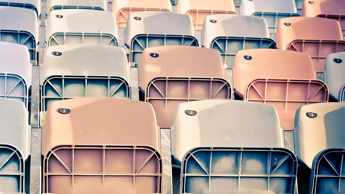

Accelerated Weathering Testing features: row of faded stadium seats

The effects of weather - sunlight, temperature, and moisture - can make printing inks change appearance caused by pigment and paper degradation. The same can happen to polymers used in outdoor or indoor applications. Product aging caused by weather stress sometimes appears faster than expected – a very unpleasant experience. A typical reason for premature product failure can be wrongly selected or insufficiently levelled UV-stabilizers. An impressive example of premature failure had been the red seats of the Raymond James Stadium, home of the Tampa Bay Buccaneers football team, which degraded much too fast due to missing UV inhibitors. “The original red seats, designed to match the Buccaneers' uniforms, had faded to “an unsightly pink over six years 1998-2004, and the paint on the stanchions has bubbled and peeled.”
Other property changes of polymer products caused by the effects of weathering can be yellowing, especially of transparent or white polymers, loss of physical strength, and gloss loss caused by micro cracks in the surface.
