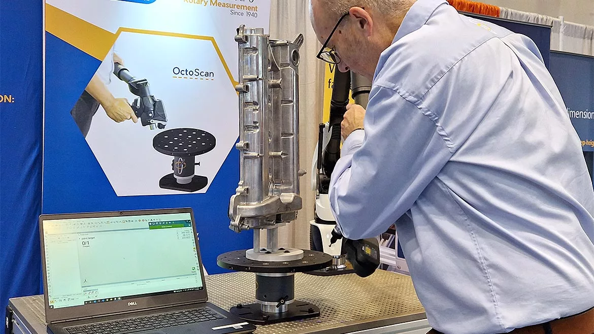

The utility of an additional rotary axis is multifaceted. For PCMMs, it significantly expands the measuring volume and facilitates the inspection of larger and more complex objects by providing additional angles of approach. Typically, to otherwise measure large objects can involve moving the measurement device around the part, or moving the part into more advantageous positions. Not only does this slow down a measurement, but can also introduce increased uncertainty in measurement values.
CMMs benefit from easier part access, streamlined programming, and a reduction in probe changes, which collectively optimize the measuring process. The rotary table’s precise control and movement can improve inspection time and potentially increase the accuracy and repeatability of measurements.

PCMM integration is typically somewhat easier. In the case of indexing tables, after hardware selection, the predominant setup steps involve software use. The table will be provided with a calibrated point map that serves as a coordinate system. This is used in the 3D software used by the measuring arm to determine the relative position of the table. This is input into the software to ensure that individual measurements and scans are correctly aligned by the software. Beyond this, simple measurement process changes are required within the measuring routine and no further setup should be required.
