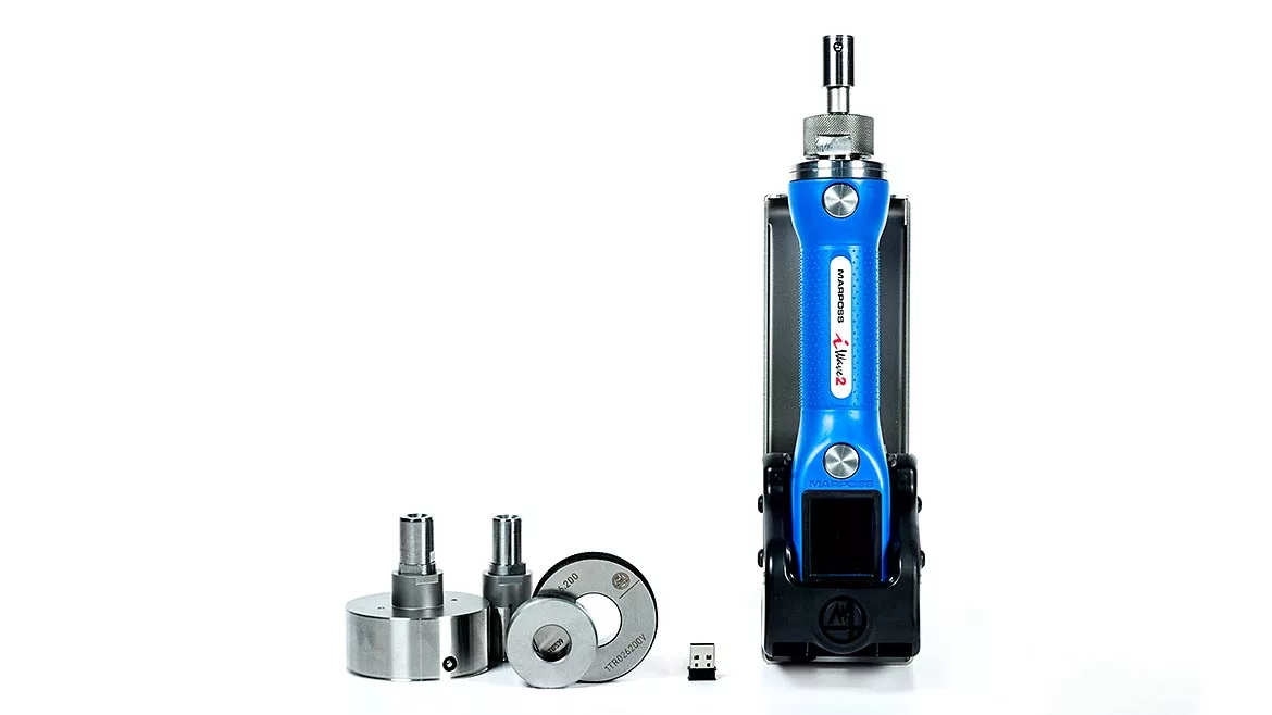

I-Wave2 from Marposs is a rechargeable wireless gage
The I-Wave2 from Marposs is a rechargeable wireless gage designed for dimensional inspection in the workshop environment. Image Source: Marposs

Michael Jeffers, Marposs product manager, TESTAR Division, offers insight into the calibration practices for Marposs's I-Wave2 probe. While factory-calibrated, Jeffers notes the necessity of regular zeroing at the shift level. While min/max masters are not essential for calibration, they are beneficial in verifying system accuracy. Jeffers points out that this practice can notably reduce the costs associated with frequent calibrations.
