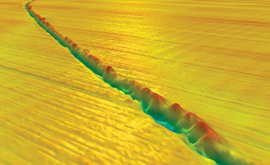

scratch on glass
This is a 3um deep scratch on glass. Source: Focalspec Inc.
