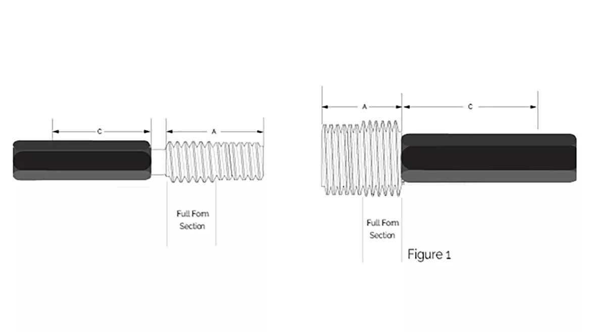

Figure 1: Truncated Set Plug
Figure 1: Truncated Set Plug All Images Source: Hemco Gages

Illustration of an adjusting locking screw
The Setting Process:
  1. Clean and inspect the thread ring gage, removing any sealing wax present.
  2. Loosen the locking screw by turning it counter-clockwise. (see Figure 1)
  3. Open the ring by turning the adjusting screw clockwise until the master plug can enter freely. (see Figure 1)
  4. Screw the ring gage onto the full form section of the master plug, ensuring no more than one thread of the ring extends beyond the plug's last thread.
  5. Turn the adjusting screw counter-clockwise, while rotating the ring on the plug, until a slight drag is felt.
  6. Tighten the locking screw. The ring should exhibit a slightly increased drag or “snug fit” compared to the initial feel. This step might require repetition for optimal results.
  7. With the set plug still inserted, tap the ring gently with a plastic or brass hammer to ensure it’s fully seated. The drag should remain consistent after tapping. If not, repeat step 4.
  8. Move the ring to the truncated portion (front half) of the master plug (see Figure 2).
  9. Verify there’s no wobble or shake in the ring. The drag should be similar to the full form section. If there’s wobble, the ring might have worn-out flank angles or lost root relief, requiring further inspection.
  10. Test for taper or bell mouth by turning the ring onto the truncated section of the master plug by 1.5 to 2 turns. If you do not feel the initial drag and it does not feel snug, but the drag increases as you turn further, this could indicate an unacceptable bell mouth or taper.
  11. Remove the set plug and repeat the process for the other side of the ring, aiming for a similar fit on both sides.
  12. Use an internal measuring device or Go/No-Go X-tolerance plain plug gages to confirm the minor diameter of the ring is within tolerance (Go plug enters, No-Go plug doesn’t).
  13. As a final step, it's highly recommended to seal the locking and adjustment screw holes with wax to prevent tampering.
