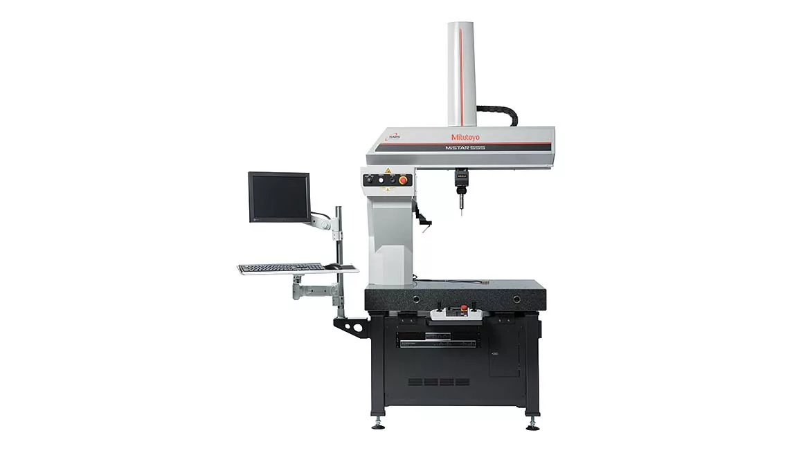

MiSTAR 555
CMMs can improve shop floor precision measurements. Image Source: Mitutoyo

CMMs are already benefiting from IoT through the integration of multiple plug-and-play tactile and non-contact sensors with metrology software and measurement databases, says Wick. This integration helps sensors and objects communicate directly with applications and databases.
When coordinate measuring machines (CMMs) enter the picture, manufacturers can improve product quality and manufacturing speed. This combination helps sensors to collect and report real-time data, significantly reducing machine downtime and the production of out-of-spec products.
