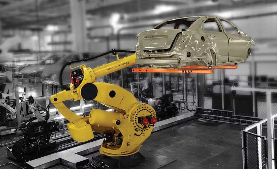

FANUC robots
It’s also important to consider any inherent inaccuracies associated with any large industrial robots, Bruce says.
“This is done by in-line calibration of the robots’ kinematic parameters, because they will change slightly as the robot itself heats up, and if this slight change is not accounted for, the resultant measurements may not meet the required accuracy,” he says.
