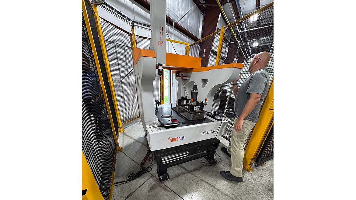

Evixmatic 20
Photo courtesy of AIMS Metrology

I asked Tim Hogan of AIMS Metrology in Miamisburg, Ohio, to tell me more. He said, “5-axis measurement productivity, coupled with shop-floor versatility and CAD-based programming efficiency is the CMM solution most machine shops are looking for in metrology.”
When I asked him about something new and/or improved he added, “We’ve provided 5-axis scanning technology on our largest shop floor CMM for automotive powertrain components, including transmission housings, engine crankshafts, engine blocks, and rear differentials to name a few.” These high-quality requirements are just a small segment of the automotive sector known for high production.
