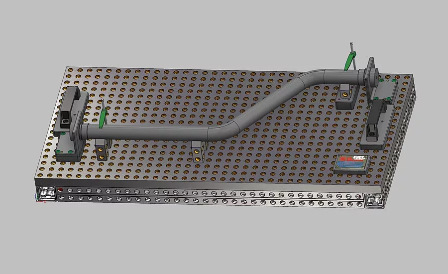

The fixture is constructed, certified and then used for the specified part or parts and either stored for future use or broken down for re-configuration on the next project. Courtesy of C2 Gauge & Fixture

Option 2. With a modular, or flexible, fixture system the manufacturing process allows the designer to make changes to the CAD data and re-designs the tool for concept approval much the same as a traditional tool build process. Often the modular design is conceived with future changes in mind (i.e. multiple parts, one tool with interchangeable holding features). It should allow plenty of clearance for the CMM to position for measurements with movable or re-movable net locators. The CMM operator or the fixture department is now ready for reconfiguration of the system. The list of re-usable components will be relocated and fastened on the surface plate or base of the fixture. The components are selected based on the design and are often within a kit that can be used over and over. The fixture is constructed, certified and then used for the specified part or parts and either stored for future use or broken down for re-configuration on the next project.
