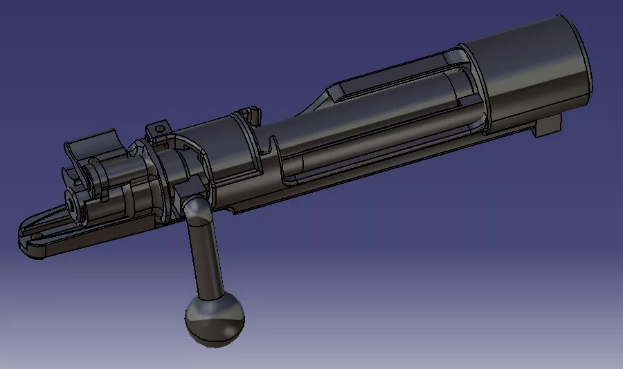

The M98 action closed. A manually operated repeater developed by Paul Mauser after years of successive designs it is considered one of the strongest of its type with hardened male locking lugs at the bolt face that when rotated mate with female recesses in the receiver.

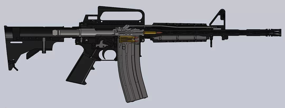

The M16 (M4 carbine variant shown) is the current U.S. service rifle developed by Eugene Stoner. It operates under the direct impingement principal where gas tapped from the barrel is transferred via a tube directly to the bolt carrier initiating the cycle.

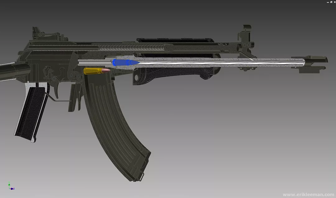

The AK 47 (Finnish model 62 variant shown) by Mikhail Kalashnikov, who first discovered his talent for designing weapons while convalescing from wounds received in battle, has become a byword for durability and simplicity. Unlike Stoner’s M16, gas tapped from the barrel is driven against a piston-type operating rod that then transfers the force to the bolt carrier initiating the cycle.
