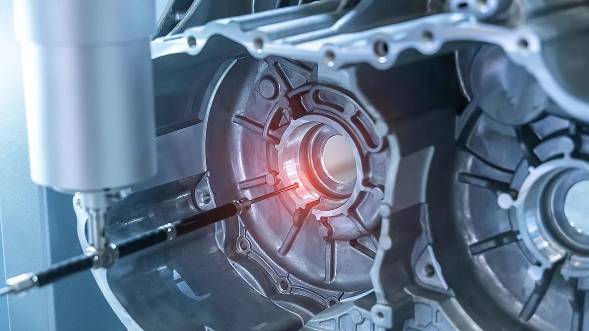

The multi-axis CMM machine measure the aluminum car engine part.

Often inexperienced coordinate measuring machine (CMM) operators will perform dimensional measurements without correctly establishing a part alignment. Manual and computer numerical control (CNC) CMM operators sometimes try to use the CMM as a 2-D or 1-D height gage.
In choosing a CMM for a measurement application, determination of the error budget often focuses on items such as vibration and temperature, but the effects of poor measurement techniques are often forgotten. Knowing the CMM software is not enough; a CMM programmer or operator must have good metrology skills, understand basic geometry and, at a minimum, know how to read a blueprint and geometric dimensioning and tolerancing. Without having the right know-how tools, CMMs, as any other gage, will be used incorrectly or inaccurately.
Incorrectly defining or failing to define a part alignment is the single most influential factor in gage repeatability errors and incorrect measurements. Consider that a perfectly round 1-inch diameter hole on a flat plate would show nearly 0.002 inch of form (roundness) error if measured as a circle and the part were 5 degrees skewed from being parallel to the current CMM axis. Never assume that because a part sits on a CMM surface it can be measured without alignment.
A part alignment accomplishes two main objectives: First, defining the part function-usually depicted on the print via datum-and secondly, establishing the coordinate system or frame of reference for physically measuring the part.
To define a part alignment, the operator must constraint, or lock, all three axes of the coordinate system to the part. This is done via the CMM software and requires establishing the direction of X, Y and Z, as well as their intersection point-origin or XYZ zero point. There are three basics steps to building a part alignment:
