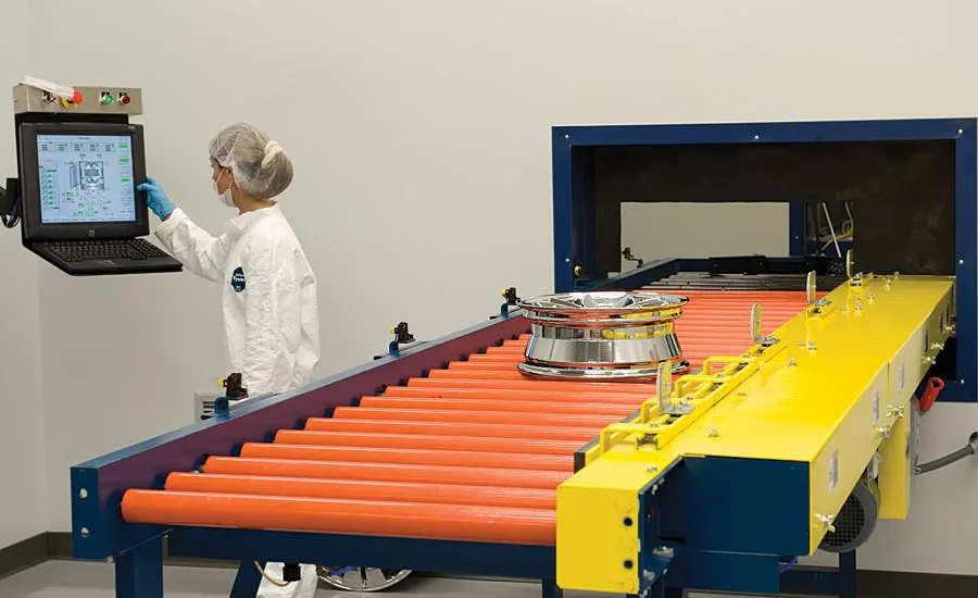

The plant floor itself seems mainly inhabited by towering stacks of finished wheels. Throughout the floor, operators keep tabs on the process and inspect the wheels.

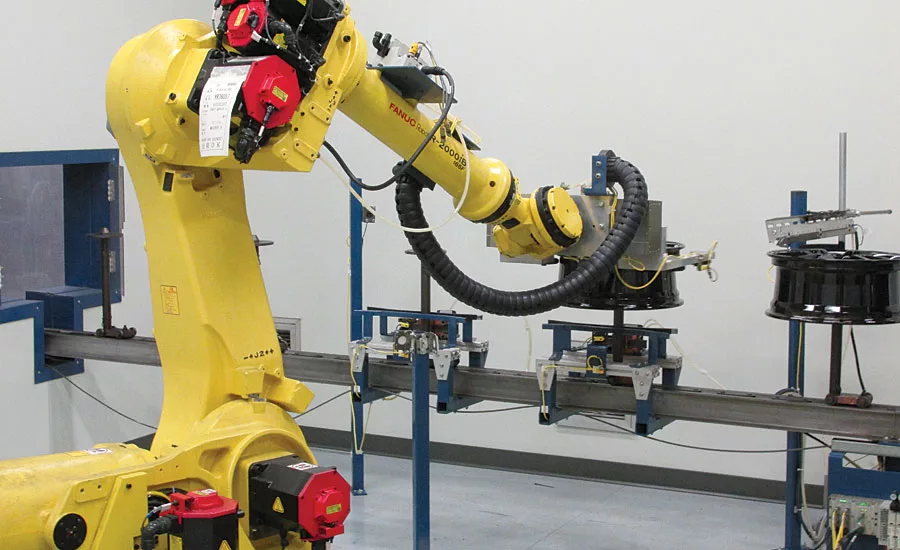

Once a wheel is on the line, robots take charge. Wheels flow through the process without human contact. (Unless it has an issue in the inspection process, in which case an inspector has an opportunity to remove small defects.)

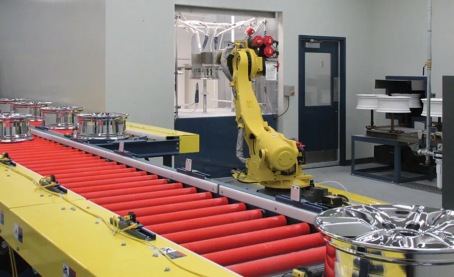

The process looks simple, but there is a lot going on. It begins with raw castings which are prepared for painting. They are washed, pre-treated and prepped. This involves several steps: a base coat, then a powder coating, then a cure oven, then a dark blue powder for the next step in the process. It goes through three curing ovens. The PVD process involves a vacuum, an alloy sprayed onto a wheel, and then finally a decompression chamber and the shiny wheel emerges.

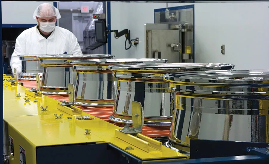

Along the way, every single wheel goes through a stringent inspection process. A defect of even half a millimeter would cause a reject. If there are any issues, the wheel is sent to a locked rejection cage so it doesn’t get intermixed with the good product. Three people inspect each wheel and then it is loaded onto the line.
