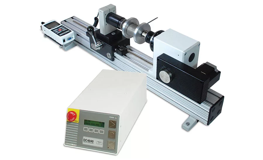

For better accuracy and repeatability on the assembly floor, a bench-mounted test stand with a torque sensor and an angle indicator is often preferable. Source: Mark-10

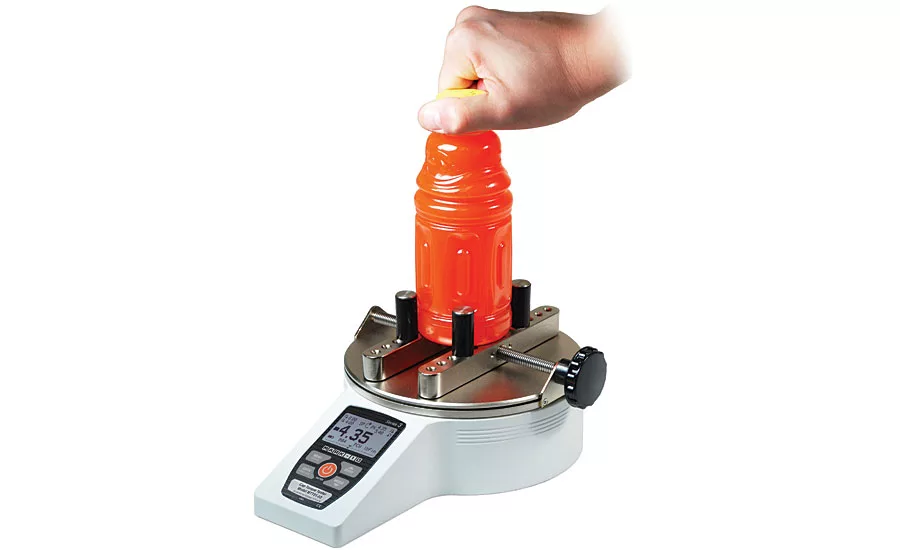

A bottle cap is tested for torque using a handheld gage. Source: Mark-10

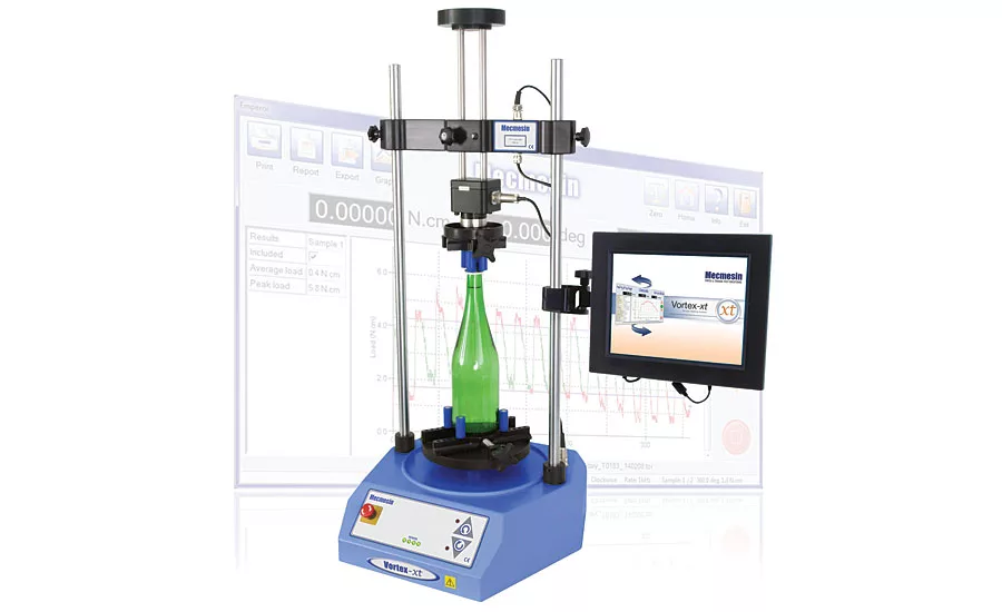

Computer-controlled torque testers use a regular PC and software to control the torque tester and provide acquisition and analysis functionality. Source: Mecmesin

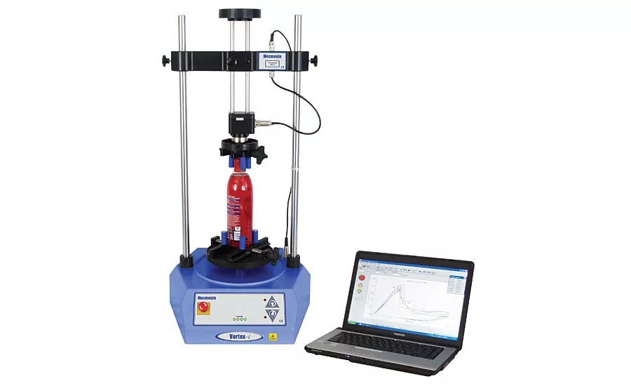

A bottle lid undergoes a motorized torque test. Source: Mecmesin

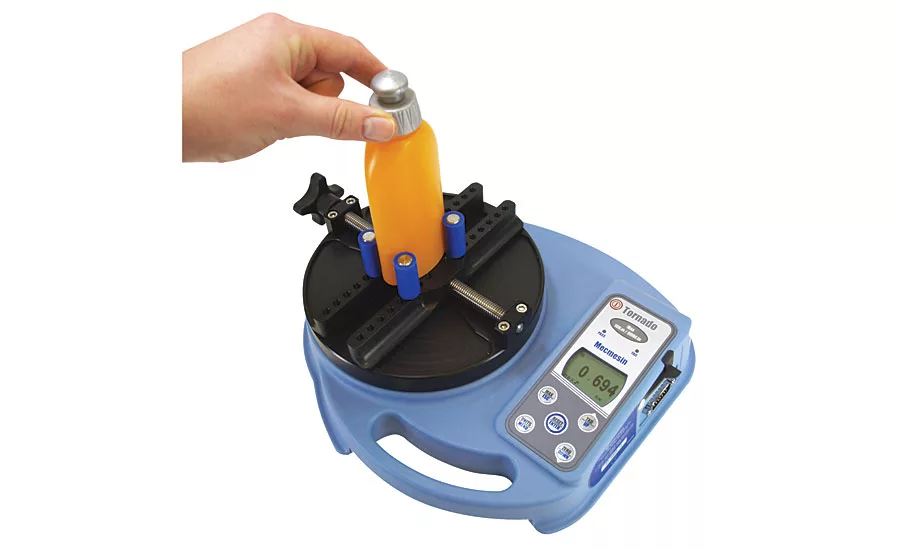

A bottle is tested with a manual torque tester. Source: Mecmesin

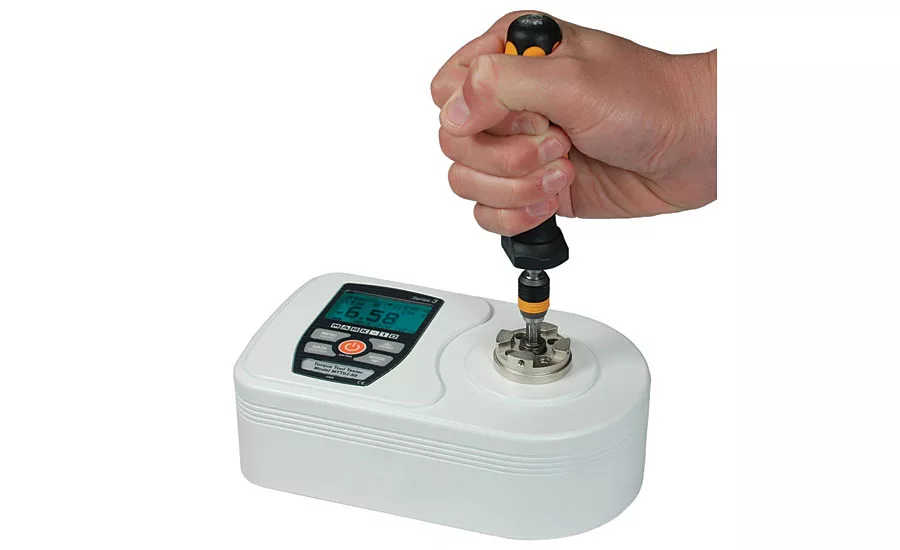

A tool is tested for torque using a handheld gage. Source: Mark-10

Computer-controlled torque testers, as the name implies, use a regular PC and software to control the torque tester and provide acquisition and analysis functionality.
“Using computer-controlled torque testers ensures optimum repeatability and reliability,” he says.
Handheld gages are common especially in R&D labs where accuracy and repeatability needs are not as stringent as on the assembly floor, says Fridman. For better accuracy and repeatability on the assembly floor, a bench-mounted test stand with a torque sensor and an angle indicator is often preferable.
“When you use a motorized test stand, it helps to ensure that there is consistency from test-to-test,” he adds. “Being able to control the speed is often required to comply with a particular standard or internally developed procedure.”
