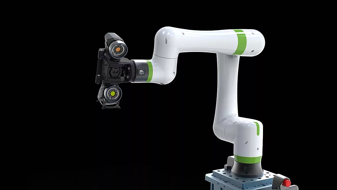

This Automation Kit can turn the HandySCAN 3D and MetraSCAN 3D portable 3D scanner families into fully fledged solutions for automated quality control applications. The arm of the Fanuc CRX-10iA/L robot can perform a highly functional underflip motion to pick a part from a table in front it and put the part on the table behind it in one single, smooth motion. Image Source: Ametek

Automation Kit for MetraSCAN 3D_Gripper_left_close.
Equipped with a collaborative robot and all associated devices, the workstation allows the 3D scanners to be used in both portable and automated mode. Image Source: Ametek

Automation Kit environment 1
Portable scanners can now be easily used as automated solutions thanks to a new hybrid solution that combines a cobot, digital twin environment software and a workstation, for an autonomous, flexible and affordable quality control experience. Image Source: Ametek
Precision in motion: advanced automation ensures superior quality control in car manufacturing. Image Source: Ametek
