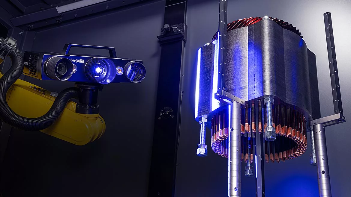

In place of traditional metrology tools, using an automated blue light 3D scanner to collect measurement data for verification further streamlines quality assurance for electric motor components through digitalization. For example, in modern electric motors, the electric conductors are assembled, bent and welded from solid copper wires to make a component known as a hairpin. The resulting geometries are challenging but necessary to inspect to ensure they conform to the correct specifications.
Hairpin-stator assemblies consist of more than 100 integrated hairpins that must be inspected accurately. Performing dimensional inspection to check that these components meet GD&T specifications is challenging with tactile measurement methods that must touch the part because these shiny, coated, and flexible components are touch-sensitive parts that deform easily. However, automated blue light 3D scanning is a high-precision noncontact solution for inspecting hairpins and other electric motor components. By automatically digitizing complete stators, single hairpins, and multiple hairpins simultaneously, EV manufacturers can quickly gain access to complete 3D measurement data from these components. Advanced 3D metrology software uses this data to generate an accurate geometric digital twin that can be used with MBD/PMI models to check GD&T specifications of electric motor components, including the complete hairpin-stator assembly, rotor and other parts requiring precision manufacturing.

While GD&T from a drawing can be manually input into 3D metrology software for use with data from a 3D scanner, embedding it into the CAD through MBD/PMI prevents an operator from creating incorrect GD&T checks. This method also drastically shortens the time required to inspect a new part, further enhancing the advantages of inspection with data from a blue light 3D scanner. The fast and accurate digitalization of electric motor components facilitates compatibility with modern design methodologies like MBD/PMI, supporting GD&T implementation that increases dimensional inspection efficiency. Other aspects of electric motor production also benefit from this digital engineering strategy.
