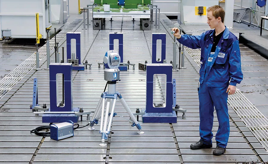

When tool engineers lay out assembly fixtures, they arrange them loosely, and then adjust the location of individual details with a laser tracker until the whole conforms to the CAD file.

When building a tool, a laser tracker is first used to get the frame structure in place. It is then used to set the details, making sure that the pins and pads are all in the correct locations. The laser tracker also allows for measurement directly against a CAD file when setting complex-shaped details.
A fabrication tool has the same locating details as an assembly tool, but it adds details with drill bushings and other structures to allow for part fabrication. In addition to what a laser tracker measures on an assembly tool, the measurements also confirm that the drill bushings and complex shape guides for routing or trimming parts are in the correct location.
After a tool is installed, the laser tracker is used to measure all the details and reference points to make sure they are correctly placed, and to establish a master reference system for future maintenance and inspection of the tool.
