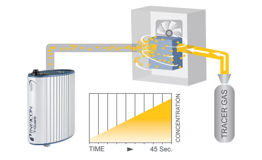

An economical method to test for leaks outside of a vacuum chamber is by using helium or hydrogen in an accumulation chamber at normal pressure. Source: INFICON

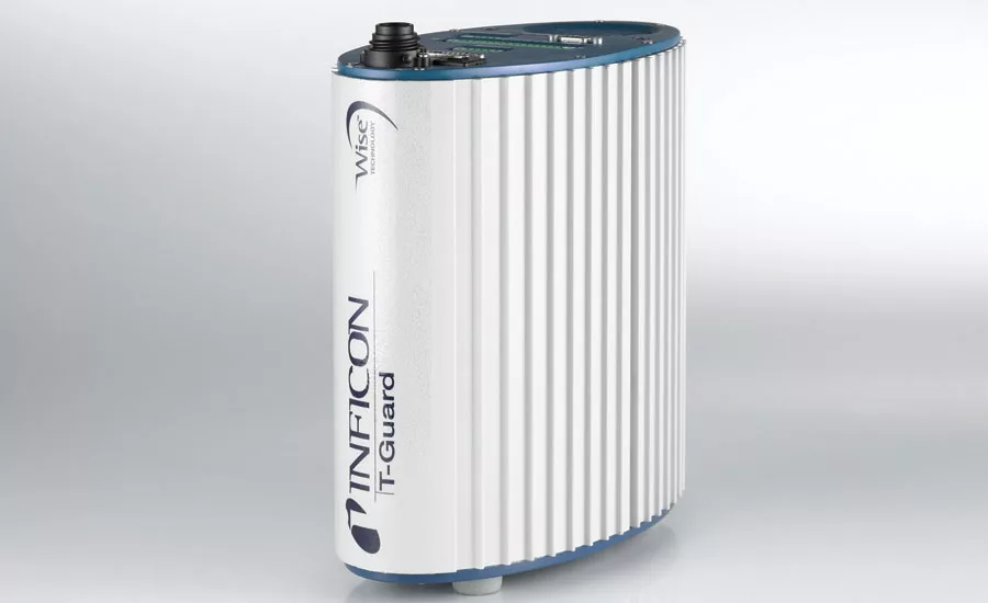

Using helium tracer gas with a patented quartz membrane sensor, this piece of testing equipment can be used on plastic and non-ferrous metal components. It delivers fast, precise results and eliminates the need for a vacuum chamber. Source: INFICON

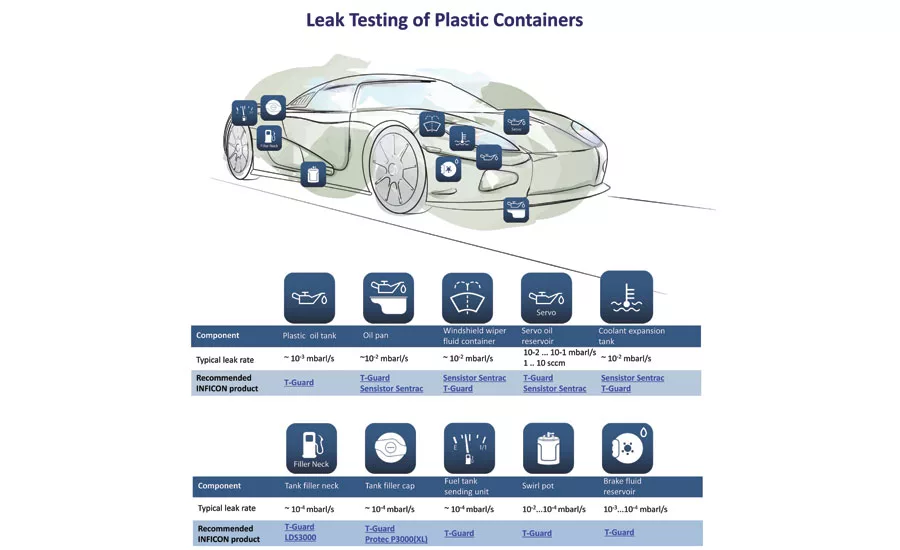

Automotive manufacturers annually produce about 90 million vehicles globally. According to Thomas Parker, North American automotive sales manager for INFICON, car makers and their suppliers conduct as many as 600 million leak tests per year on plastic vehicle components, including fuel, brake, steering and cooling system parts.
Areas at risk for leaks include plastic containers for lubricants, coolants, brake fluid, hydraulic fluids, and windshield wiper fluid, as well as plastic fuel lines, plastic filters, surge tanks, filter housings, pumps or batteries, gas tank caps and tank fillers.
It once was considered routine for a driver to occasionally top off fluids in a vehicle. Today’s standards are much different and a part is considered defective or of sub-par quality if a car owner has to perform this type of vehicle maintenance—maintenance that could have a negative effect on brand image.
Charge air coolers, often made from metal as well, are currently tested against leak rate limits of 10-2 mbar l/s, servo oil containers, tank fillers, gas tank caps and lines already are at 10-4 mbar l/s. Yet the latter are already impermeable to liquids at a value of 10-2 mbar l/s. Why the stricter leak-rate limit? These components must contain evaporation vapors almost completely. Besides quality demands, stricter emission regulations also are driving industry standards upwards. Leak detection methods are becoming more precise, but must be affordable as well.

Leak testing with air also has reached its limits, and vacuum testing in most cases is too expensive. However, there is a gap between the two (in a range from 10-2 to 10-5 mbar l/s) which is being filled by newer automated high-performance test methods. Leak detection with helium or hydrogen in an accumulation chamber under normal pressure (accumulation method) can now fill the gap in an economical way. Hydrogen can be used as well as helium and is priced even lower as a test gas, although it does not provide the same sensitivity.
Because a mass spectrometer cannot be used under normal pressure, a highly-sensitive sensor operating at atmospheric pressure is required. Sensors based on patented Wise technology, for example, can measure an increasing helium concentration in a test chamber at atmospheric pressure. In the chamber, the test part is filled with helium through a test-gas connection so that the gas can escape through any leaks into the accumulation chamber. Internal fans ensure an even distribution of the helium in the chamber, so regardless of the position of the leak, precise measurement values are guaranteed. The sensor determines the amount of gas content in the chamber.
Leak-detector sensors with Wise technology consist of an evacuated glass cell with a quartz membrane that is permeable to helium. The membrane is like a sponge interspersed with small capillaries through which only helium at a molecular level can penetrate.
Under laboratory conditions, leaks in a range of 10-6 mbar l/s can be reliably detected. During production operations with a free volume—the volume of the chamber minus the volume of the test sample—of five liters in the test chamber, leak rates of 1*10-4 mbar l/s can be detected in less than 30 seconds.
For a free volume of one liter the same leak rates can be detected in just 11 seconds. Including setup time, the time per test sample is about 16 seconds, which yields 225 test samples per hour. In addition to speed, the accumulation method is especially suited for testing plastic components because the expansion component becomes irrelevant.
To check the system, measurements are done against test leaks. By positioning the test leak at different places in the test chamber one can also test to see if an even helium concentration in the test chamber has actually been achieved.
