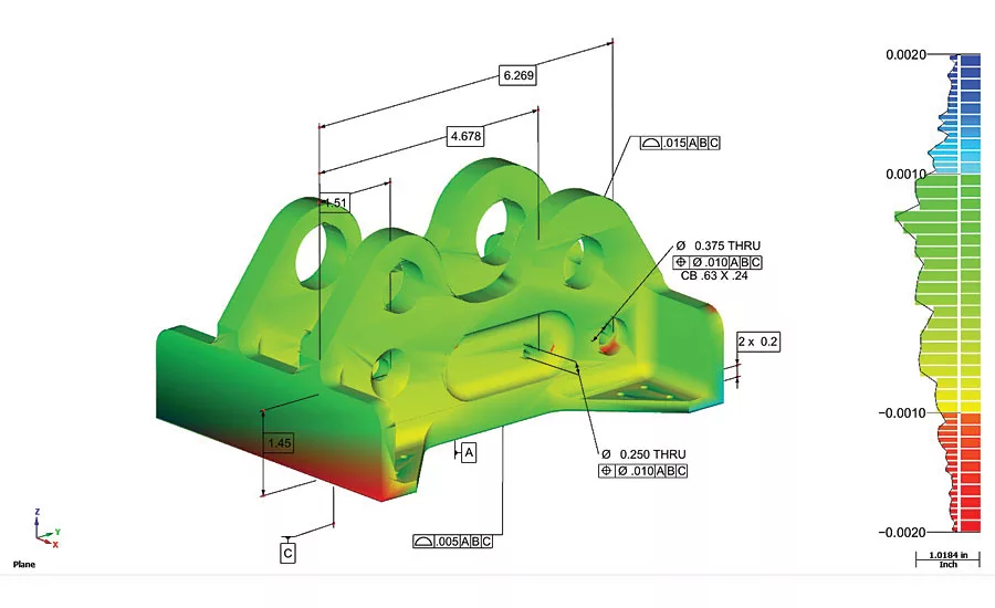

This software provides real-time color coded inspection feedback tied directly to intelligent GD&T definitions. Red – out of tolerance, high; Green – in tolerance; Blue – out of tolerance, low. Source: Verisurf

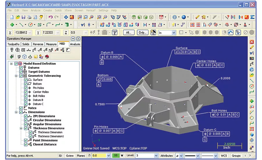

If your inspection software is based on a 3D CAD platform, you can import Intelligent GD&T data directly along with the 3D model. Source: Verisurf

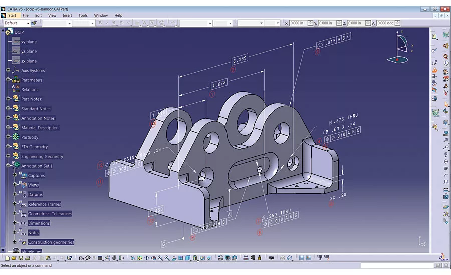

Computer Aided Design (CAD) - Dassault Systems CATIA model with GD&T annotations and inspection balloons generated with Inceptra MBD Accelerator. Image courtesy of Inceptra

Computer Aided Inspection (CAI) – Verisurf MBD inspection software analyzes point cloud to CAD model nominal and displays deviation color map. Green is in tolerance. Blue is out of tolerance out of the part. Red is out of tolerance into the part. Source: Verisurf

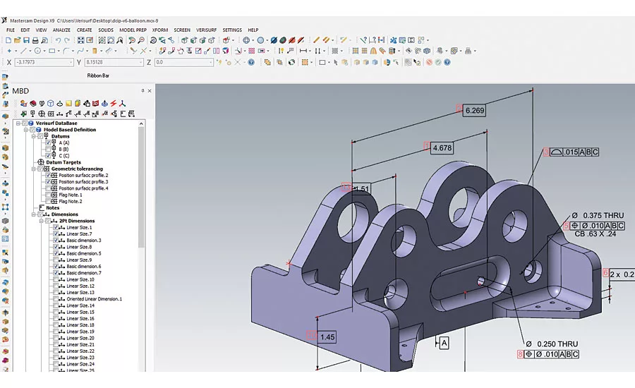

Computer Aided Manufacturing (CAM) – Mastercam CNC machine programming software with optional CATIA MBD imports CAD with model associative GD&T. Imported GD&T annotations can be edited and additional annotations added as part of the manufacturing engineering process. Source: Verisurf

Quite often, approved product designs lack necessary detail for manufacturability. Critical overall tolerances are usually indicated, but typically supporting specifications must be further defined as intelligent annotations. There are two formats of GD&T definition data. Although both are labeled “3D annotation,” one format is purely for display; the other feeds downstream applications. Presentation is the display only format for GD&T. While the tolerancing may be associated to the model, the information is just text. There is no intelligence behind the 3D annotation. As a result, the GD&T data must be interpreted. The presentation format is similar to typing a mathematical equation in Microsoft Word. It conveys information, but the computer cannot use it in a calculation. This type of GD&T data is commonly referred to as “decorating the model.”

Considerable intelligence and value can be added to the MBD CAD model authority during manufacturing engineering, depending on intended processes and equipment being used. When producing legacy parts, for example, in support of Maintenance Repair and Overhaul (MRO), CAD data is not always available. Often in these situations a capable CAD based reverse engineering application can be used to reverse engineer missing features back into 3D CAD while providing important GD&T data to support manufacturing and downstream inspection. This same process can be used to geometrically define a complex surface profile.

If your inspection software is based on a 3D CAD platform, you can import Intelligent GD&T data directly along with the 3D CAD model. In the case of presentation annotations, the quality or manufacturing engineer can determine which are relevant and simply add the GD&T specifications to the 3D CAD model when developing the inspection plan.
When the information is imported from the native CAD system as a GD&T representation, there is a true MBD implementation. The authority of the dataset is preserved. The same is true if GD&T display data (presentation) is imported directly or via STEP translation and then entered into the inspection application.
