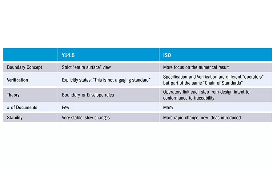

The table summarizes the differences described in this article. Each of these differences can be viewed as favoring one standard over the other, and I would like to emphasize again that the adequate training of personnel is of great importance. As I expect many organizations, particularly international companies, have legacy drawings that reflect both standards, the understanding of the differences is equal in importance (in the short term) to the choice of standards for future documents.
