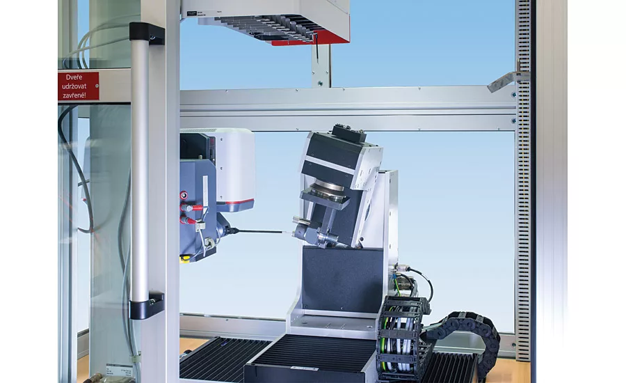

This measuring station concept with five positioning axes is particularly recommended for complex workpieces with awkward measuring points, such as injection system components, pump bodies or components from automatic control gears. Source: Mahr

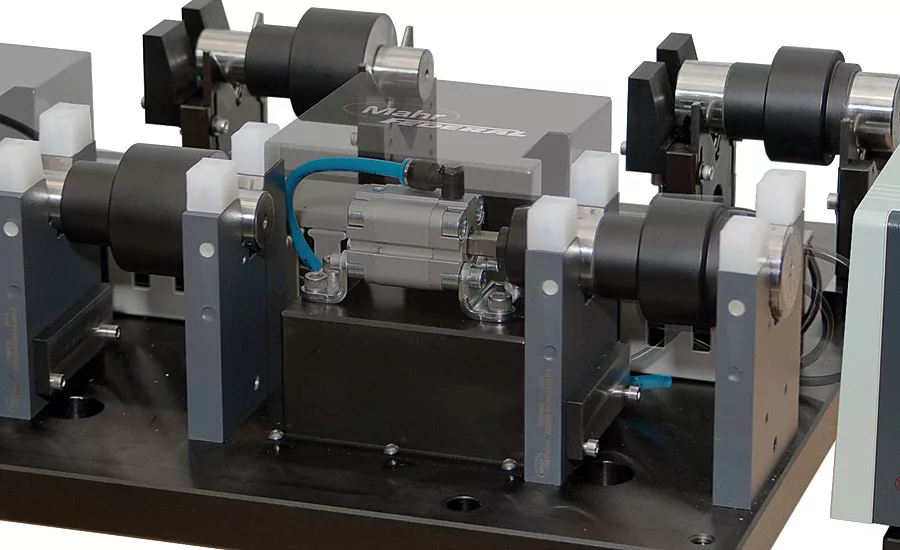

Another way to save time and provide a different level of automation is to make multiple checks in sequence. Source: Mahr

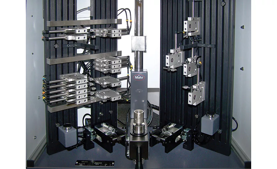

Fully automating the measuring process is the ultimate custom gage solution. Source: Mahr

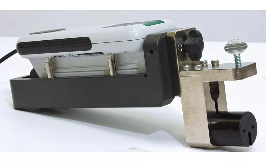

A hard-to-access surface finish check is the measurement of surface profile on camshaft bearing bores in an assembled cylinder head. Source: Mahr

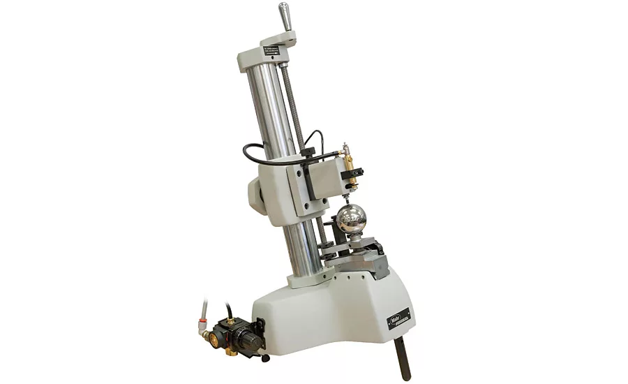

A simple piece of special fixturing on a standard gage can significantly reduce operator time to position and measure the part. Source: Mahr

A simple piece of special fixturing on a standard gage can significantly reduce operator time to position and measure the part. An example of this is an off-the-shelf precision height stand that was recently customized for high accuracy balls used in precision rotary bearings by adding some special fixturing and automating the measuring system. Simple design changes, like tilting the stand to help seat the ball and creating an easy-to-adjust fixture to handle a wide range of ball sizes, sped up part staging. Employing an easy parallelism adjustment and a footswitch to control the probe saved significant time in the measuring process.
Measurement improvement was also seen due to the consistent forces being applied to make the measurement.
The same fixturing concept can be used to help speed the process for making surface finish checks at the point of manufacture. A hard-to-access surface finish check is the measurement of surface profile on camshaft bearing bores in an assembled cylinder head. This is difficult because once the head is assembled, the bearing bores no long have open access. Trying to stage the part on a surface plate and position the cylinder head to the probe—usually with a very long stylus on a surface profiling system—is very time consuming and nowhere near fast enough for use at the point of manufacture.
To help automate this gaging process, a set of custom fixtures was specifically made to make the measurement easier and increase performance. The solution starts with a fixturing plate that is attached to the cylinder head to provide location marks for the custom surface finish system. This consists of a standard mobile profiling system with a special probe tip and alignment tool paired to the fixturing plate. This provides two important functions: 1) it positions the probe into each of the eight cam-bore checking locations; and 2) protects the delicate probe tip during insertion and extraction. This custom fixturing reduced measuring time and operator involvement, and generated better measurement results.
Another way to save time and provide a different level of automation is to make multiple checks in sequence. A common shop floor practice is to provide a series of tools for the operator to use in a specialized gaging station. Often these gages can be connected to a gaging computer through a wired or wireless network. The computer can then provide a guided gaging sequence for the operator, informing him what gage to use in the gaging process, helping him make the measurement with pictures/instructions, and collecting the data to provide feedback for part qualification. These workstations and the guided sequence provide a sort of automation to give the user clear steps of the process to follow, while all data collection and part qualification is done automatically, thus reducing operator involvement and measurement time.
Measuring time can also be greatly reduced by building a gage that makes multiple measurements at the same time. Many gage builders have begun using what are known as ‘standard elements’ to create multiple dimensional measurement systems configured for the part. The use of these standard elements allows a custom gage to be created in a relatively short time for fast implementation, and then potentially allows the gage to be reconfigured for families of similar parts. With this multiple dimensional measuring solution the gaging sequence is compressed into a one shot measuring cycle.

Fully automating the measuring process is the ultimate custom gage solution. It takes the operator completely out of the picture and can run lights out in a very reliable manner.
There are two levels of custom gage automation involving part movement within the gage: the gage can be designed for an automated process as a standalone station; or the gage can be part of the manufacturing process and take over for some portion of the part handling within the manufacturing cycle.
Gages designed as standalone stations are often robot fed and may or may not include part manipulation/movement. Standalone stations have all the gaging components in place with the measuring system sending information back to a main controller. The gage often will use sensors to verify to the process controller when a part is in place, when to take a measurement, and when to provide gaging results for disposal. These custom solutions are specifically tailored to the speed of the process, the part tolerances required, the environmental conditions of the process, and the capabilities of the system bringing the part to the gaging station.
In some cases part measurement automation is accomplished within the manufacturing process by using a combination of standard automation modules and a standard surface/profiling system. The modules include X/Y slides, rotary tables, probe holders, and custom fixturing. Using CNC software, completely automated measuring cycles can be created for complex parts. This measuring station concept with five positioning axes is particularly recommended for complex workpieces with awkward measuring points, such as injection system components, pump bodies or components from automatic control gears. During the fully automated measuring routine the workpiece is moved to the positions required to complete the measuring task. Measuring positions that are difficult to set manually can be reliably reached.
