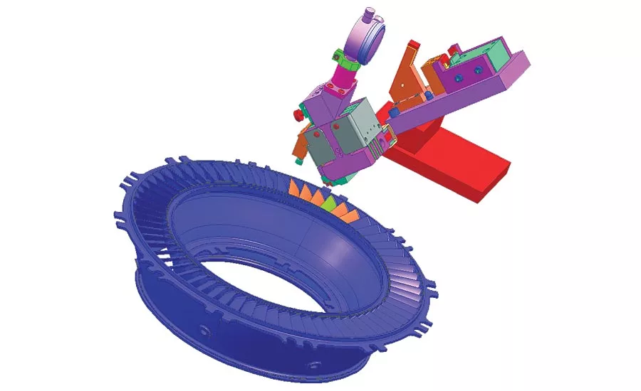

Custom vane gage shown on CAD drawing
Custom vane gage shown on CAD drawing designed by Starrett Special Gage. Source: The L.S. Starrett Co.

Consider an exotic aerospace defense part with a labyrinth of grooves, vanes, holes, slots, shoulders, lands—a non-standard part worth well into five figures per unit. After designing and manufacturing the part, the manufacturer realized there was no way it could accurately measure the part. Pressed to deliver the part, the manufacturer sought a solution for the quandary and consulted our special gage division. After quick and intense analysis, a solution was drawn up, approved, and a custom designed and built gage was provided that ultimately solved their problem.
