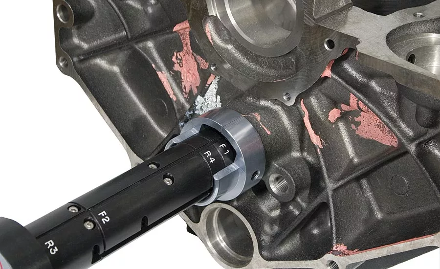

Deep Blind Holes
Bores are typically easy to perform surface finish measurements on in a shop floor environment. That is, of course, if the bore is accessible and the measurement depth is kept to a minimum. Engine block camshaft and crankshaft bores, however, are often deep blind holes (up to 500 mm for most engines), and are so small in diameter that a typical surface finish drive unit will not fit inside for proper location for measurement.
snap gage
Just as important as the bearing and crank journals are the thrust faces they ride against. Another snap gage concept is used to position the surface finish probe here, and with the same thoughts in mind: easy to use, no operator influence, and protected probe positioning.
Typically the surface finish drive unit must be kept external to the bore and a long measurement probe extension used to reach the middle cam and crankshaft bores. However, the ideal solution for performing such measurements is to bring the measurement drive system directly to the surface to be measured.
A dedicated gage can position the drive unit and measurement probe directly over the surface to be measured without the need for long measurement extensions. The drive unit itself is small in diameter and it can be placed within the bore directly over the measurement location.
