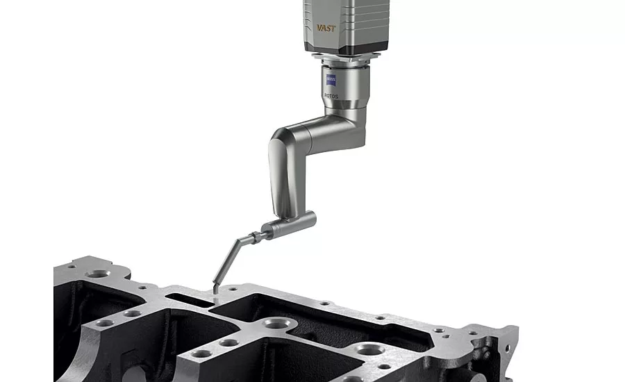

Modular design
Modular design and rotation in three axes—each featuring ±180 degrees—allows a stylus to reach all areas of a part for inspection. Source: Zeiss Industrial Metrology

Increased range of motion with sensor design has also enabled CMMs to better access all areas of the part. With Zeiss’s Rotos sensor, all three axes allow for full rotations of plus-or-minus 180 degrees, allowing a CMM to perform surface measurement inspections immediately following dimensional measurement inspections without re-fixturing the part. This eliminates the need to take the part from the CMM to the dedicated surface finish gage, therefore allowing for a possible cycle time reduction and less part handling by operators.
It was important to design a product that allows for accessibility to the different features that need to be measured, whether they are small holes, or recesses, he explains. “Or let’s say you have a large part and you’re holding it in a fixture, and there’re features on the bottom of the part that need to be measured, but the customer doesn’t want to re-fixture the part, so allowing for flexibility in the surface finish pickups that are available to access those different features was a big consideration.”
All of this is also made possible by automatic probe change.
“So we might have a traditional CMM sensor that does all the dimensional checking with a stylus system, different ruby styli, or other traditional CMM probe tooling,” he says. “What happens is, we drop off the traditional probe tooling in the rack, and then we pick up the surface finish sensor that has the appropriate surface finish pickup attached to it. Then we go through and do all of our surface finish measurements. So it’s just another tool that goes in the rack that gives greater capability and flexibility. And with that, the software has the analytical tools needed for the surface finish evaluation, as well.”
