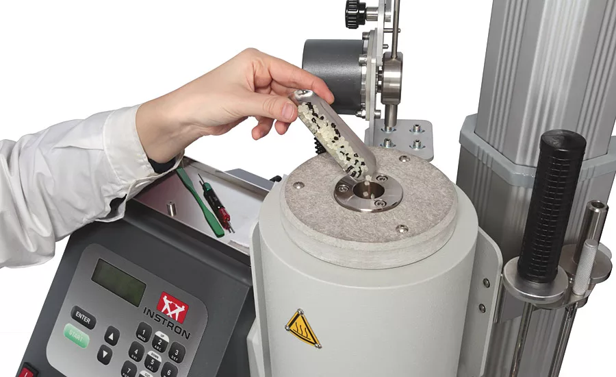

MELT & PROCESSABILITY PROPERTIES
The raw material producers must control the quality of polymers they produce to assure their customers that the supplied polymers meet the requirement for specific applications. One of the key properties related to the processability is the Melt Flow Rate (MFR), which can be determined using a melt flow tester. The MFR is described as the mass of a material flowing through a die in a certain amount of time, at a specified temperature and the value of which is reported in g/10 minutes. Simply put, it measures how easily a melted polymer flows. The Melt Flow Tester is an easy-to-use tool to check the quality of a polymer, helps with selecting the best grade of polymer and predicts the polymer behavior in a number of processing techniques.
Following ASTM D1238 and ISO 1133 standards, polymer producers and manufacturers can verify the quality of the product they receive from their supplier. Both these international standards describe the testing procedure and accuracy of test measurement in detail. A polymer sample is melted in a heated barrel and a specific load is applied onto the sample with the aid of a piston which pushes the material to flow through a standard specified capillary die. The amount of sample flowing out in 10 minutes is measured. When a polymer has a low MFR, its material processability is deemed lower, while a higher MFR value represents easier processability.

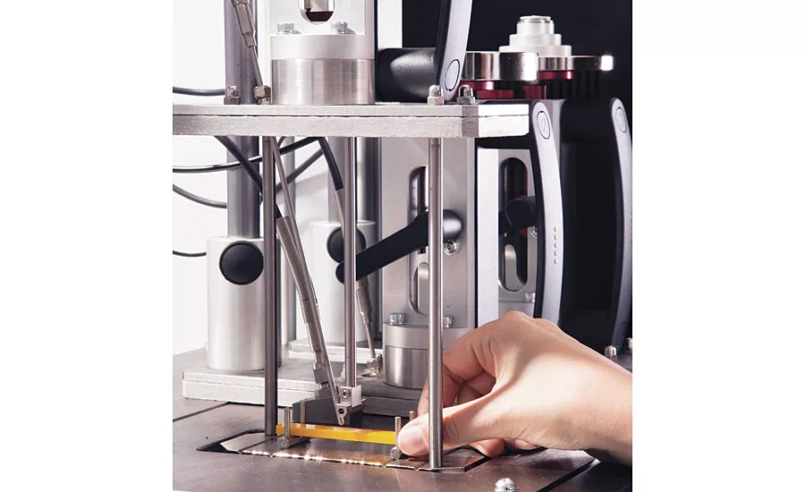

THERMO-MECHANICAL PROPERTIES
Heat Deflection Temperature (HDT) and Vicat Softening Temperature (VST) tests are usually performed to evaluate the ability of engineered and high-performance polymers to retain their mechanical properties at high temperatures. ASTM D648 and D1525 provide detailed testing procedures for this material property measurement. The polymer specimen is immersed in a fluid bath whose temperature is raised uniformly at a specific temperature rate. A predefined load or stress is applied to the specimen in order to measure the temperature at which it shows a set deflection (HDT test) or penetration (VST test).
ASTM D648 standard describes HDT as the temperature at which a deflection of 0.25 mm (0.010 in) occurs under a predefined applied stress of 0.455 MPa (66 psi) or 1.82 MPa (264 psi). The testing specimen is placed in an edgewise position in a three-point bend fixture and the assembly is immersed in a silicon oil bath whose temperature is raised uniformly at the rate of 120°C/h. ASTM D1525 standard defines VST as the temperature at which a needle tip of the fixture penetrates into the sample to a depth of 1 mm. This standard allows for two different mass applications: 10 N or 50 N and two different temperature rates: 50°C/h or 120°C/h.
Consider this scenario as a simple example of the value of HDT testing to your everyday living: a heavy shopping bag is left on the dashboard of your car on a hot summer day when the temperatures inside the car could reach up to 50°C (122°F). If the material used to make the dashboard cannot support the weight of the bag at this temperature, the dashboard can potentially deform and be damaged.
Higher HDT and VST values obtained in a test signify that the tested material is suitable for high-temperature applications, making it a preferable material for automotive applications. But in addition to the bulk properties, HDT and VST test results also provide input on the surface properties of a polymer. At temperatures higher than those established by an HDT or VST test, it can be anticipated that the polymer sample undergoes permanent deformation generating further surface defects.

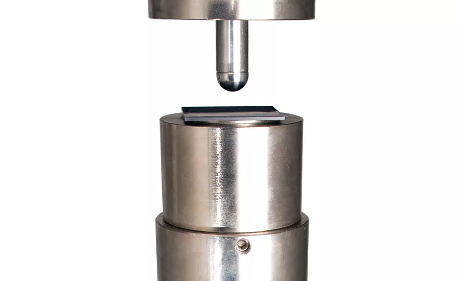

Understanding material failure properties helps engineers resolve and prevent failures by identifying the causes of degradation, damage, aging, stresses and processing issues. The automotive industry has stringent safety standards where every single critical component has to be tested and be in accordance with precise technical specifications. Strength, durability, and safety-related characteristics are the main properties that are repeatedly tested. For example, car dashboards are designed to absorb shocks and require impact-resistant polymer components, designed such that in the case of an accident, the dashboard area will absorb a significant amount of the impact energy.
Impact testing on plastics and composite components becomes significant and is often used to help understand material failure properties and characterize mechanical resistance of polymer components to impact. Impact resistance is a critical measure of service life and is primarily responsible for ensuring product safety.
Impact testing makes it possible to distinguish between brittle and ductile polymers and simulate material behavior at different temperatures and/or at different impact speeds. The testing is standardized in accordance with various ASTM and ISO standards to ensure compliance of polymer components in automotive applications. The standards detail the testing requirements and test procedures, and also help establish the criteria for the amount of energy required to break a material. The most common impact tests are Izod and Charpy tests complying with ASTM D256, D4812, D6110 and ISO 179 & 180 standards. Both Izod and Charpy tests involve striking a standard sample with a controlled weight pendulum at a defined velocity. The amount of absorbed energy is measured as described in the method and gives a quick reference check for the QC/QA labs of automotive suppliers. Another test suitable for both QC and R&D labs is the drop weight impact test. It can be carried out on a standard specimen of raw polymers or finished components, to accurately measure the absorbed energy and impact resistance.
