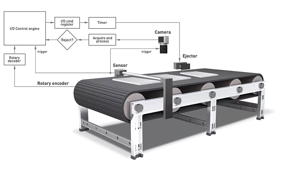

Figure 2: Typical system with real time IO control. Source: Matrox Imaging

INTERACTION THROUGH DISCRETE IOS
A vision system with proper discrete IOs can handle the tasks necessary for tending to simpler production processes. This approach, if workable, can result in substantial cost savings by eliminating the need for a PLC. The vision system’s discrete inputs must be able to catch and store successive external events while waiting for the main program to get to them for processing. The vision system’s outputs must be able to be set at specific times and for specific durations based on either relative (example, encoder pulses) or absolute time bases. A hardware-assisted implementation of these discrete inputs and outputs ensures that the above capabilities are delivered. (See Figure 2.)
An example of such hardware-assisted implementation is a vision system used by a major device manufacturer for inspecting a high-value rod-like device. The rod-like device needed to be precisely rotated in smaller increments, up to 180 degrees, for a proper complete inspection. The rotations were done using a stepper motor, which was driven by pulses of specific duration from the vision system. Apart from the integrated motion control, other complex aspects to contend with in the project were contrast between surface and background being poor and having to take multiple measurements at known intervals. This manufacturer was able to save thousands of dollars by doing away with PLCs and also saved space and power supply.
